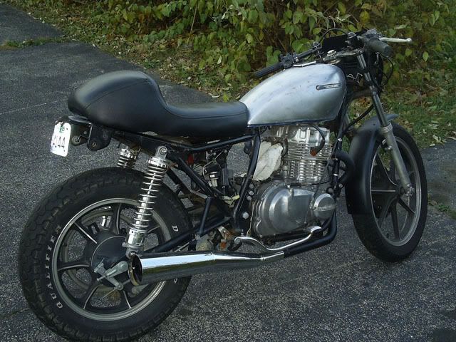

Just an update: this is a current photo. Obviously it's a work in progress (note the lack of carbs).
Man that thing looks like a lot of fun!! (well when it's running)

That thing's gonna be pretty cool! Did you have that seat custom made?

I actually found the seat on ebay. It was made from a Honda 350 seat pan. The clipons were fabbed by my bro, though.
