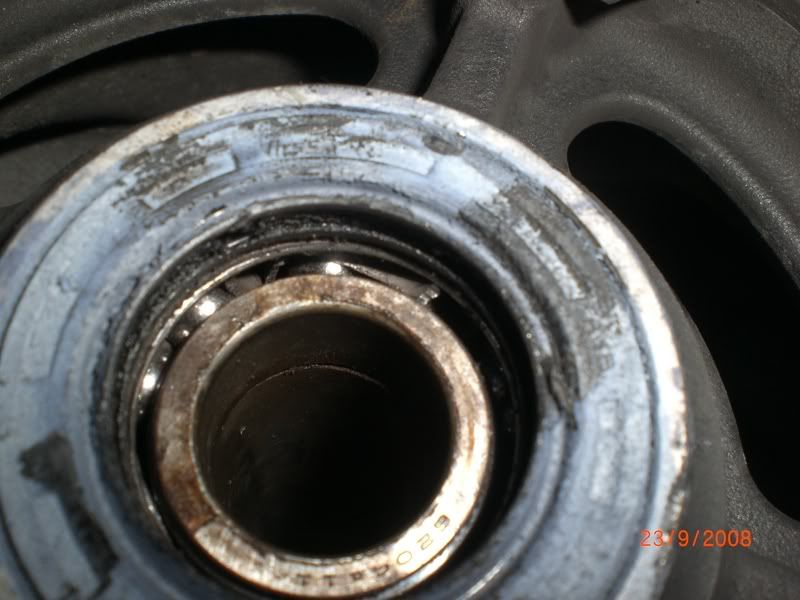

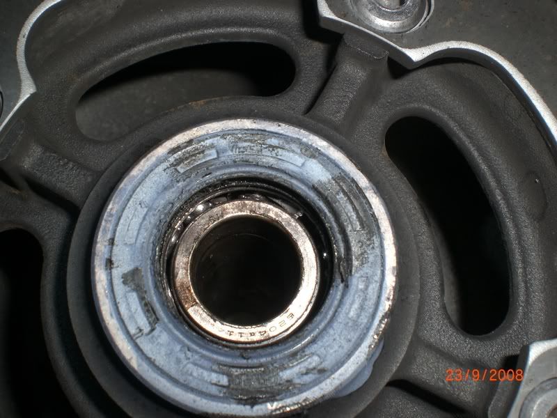

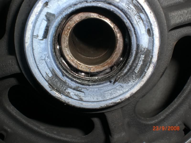

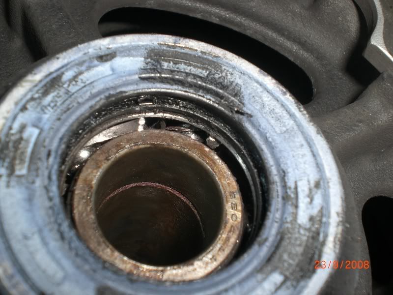

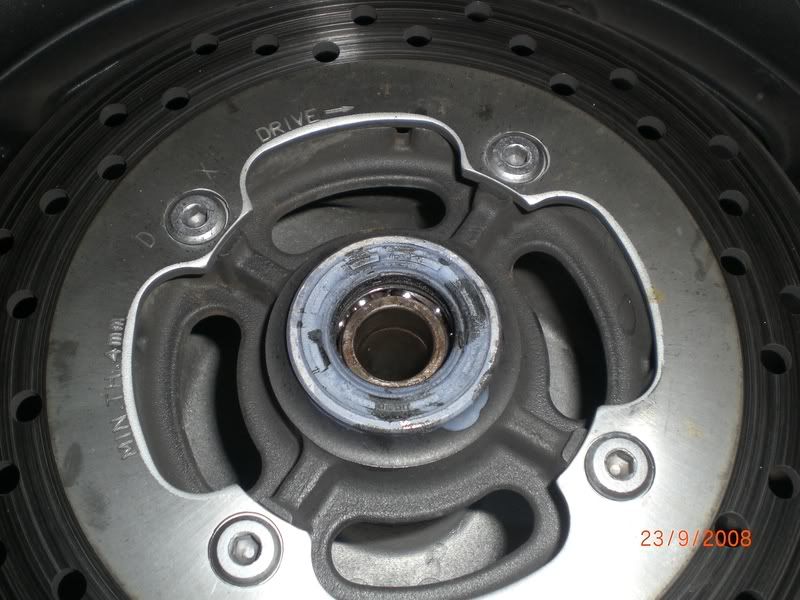

Well, took the rear tire off this morning. The left bearings are good gonna grease them though. As for the right side....pretty sure I found the problem.

yep... they are definatly not supposed to look like that.. glad you found the problem before something got permanantly ruined.. other than that bearing which looks like it isnt good except for giving you a little slingshot ammo...

Looks like 2 or 3 of them are missing collars, and I wouldn't think there is supposed to be that much space between bearings. I might have completely lost one of them.
