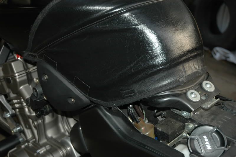

I'm looking at this thing. Has clips on one side and velcro around little tubes on the other.
I'm normally good at figuring things out, but this is a head scratcher.
Anyone have pics of one installed, or any tips?

I have one, Larry. I wanted to take some pics before I replied.
First, take the seat off, then loop the elastic band over the front of the tank, then under it. The loop just sits there under the tank holding the bra forward in tension.
These pics show where and how the 2 velcro tabs attach to the left side of the bra.
You see, the purpose of the tubes is for them hold the bra in place once the small side cover is installed. I think the reason for the velcro system is so you don't have to unbolt those covers in order to clean behind the bra every now and then; otherwise, it will be more cumbersome to clean up dirt/debris/dust that accumulates behind the bra, eventually scratching the tank.
The right side stays, and is held in place by the small right side cover.
Once in place, put the seat back on.

Ah! Now that makes sense. Thanks for the reply and the good pics.
