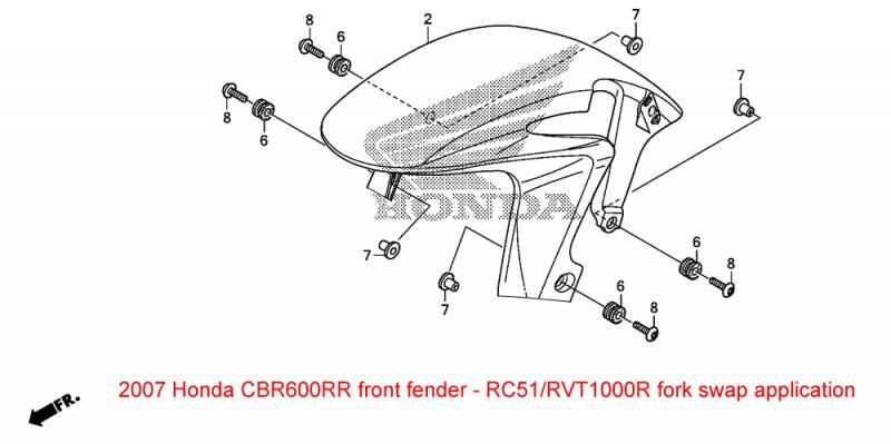

'07-'13 CBR600 front fender with OE collars, rubbers (pre-emptive TWSS for MM), washers and 6mm x 20mm allen bolts (4 of everything) If you want a basic matte/flat black, use the Mat Gunpowder Black Metallic An example of a gloss black would be the Graphite Black. Of course, you can just use a carbon fiber fender off ebay
* Pic (not mine)

post #2 of 152 Old 08-03-2013, 09:12 PM Thread Starter

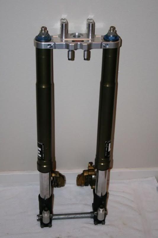

Photoshop'd pic of mod needed with '07 CBR600 fender.
Fiche cleaned up for easier viewing.

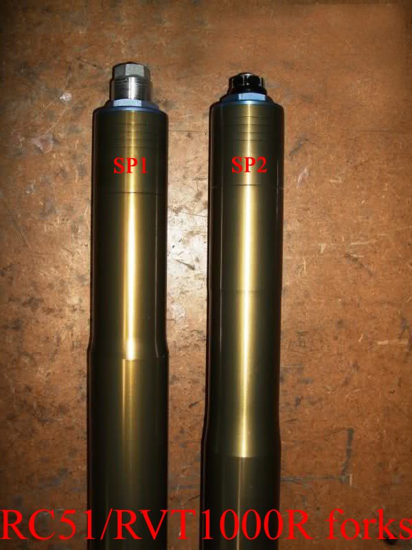

Forks visual differences (not mine):

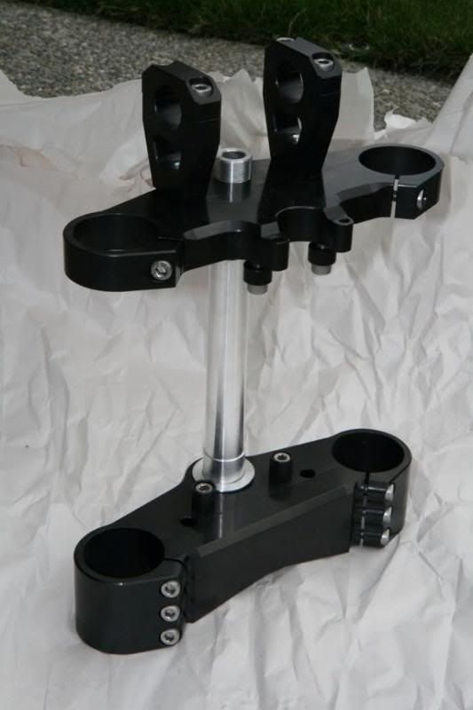

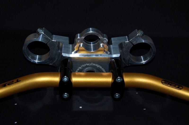

Hohey Designs 929/954 triple with added benefit that their clip-ons can be used without removing the clamp
Spiegler Performance Parts LSL triple
post #4 of 152 Old 08-04-2013, 01:44 AM Thread Starter
Style and Performance kit
2011 (likely all years) CB1000R triple
post #5 of 152 Old 08-04-2013, 02:48 AM Thread Starter
The CB1000R clamp does not require drilling for the front bracket but does require using it's rubber insulators.

post #7 of 152 Old 08-04-2013, 06:59 AM
Both Sp1 and Sp2 forks will require shimming.
The lower diameter clamping surface on the fork leg of the SP1 is longer, allowing more adjustabilty up and down in the clamps.

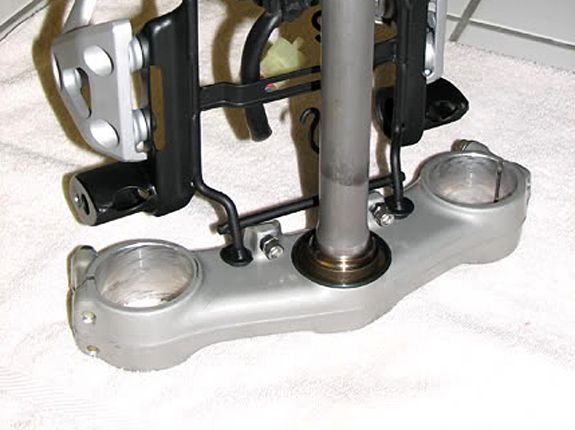

post #8 of 152 Old 08-28-2013, 05:30 PM
Posts: 4,608
Emig Racing stem

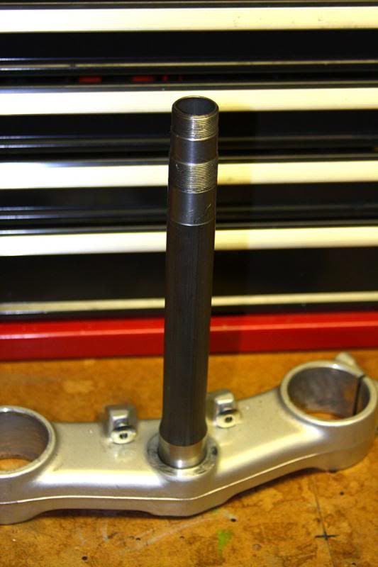

post #9 of 152 Old 08-28-2013, 05:41 PM Thread Starter
CB1000R stem

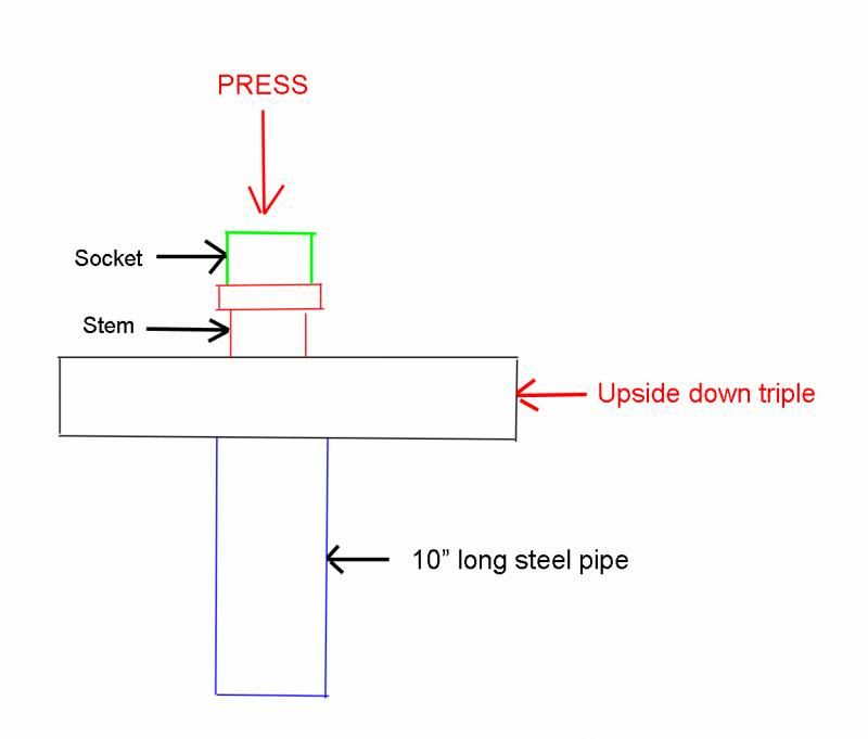

How to Press Steering Stem
Dan and I have been talking about the correct way to press a steering stem on another forum and I figured I'd post it here. The correct way is to keep the pressure around the stem bore area and not at the triple clamp ends.
These pdf's are very good.
http://www.appliedrace.com/Stem%20Removal.pdf
http://www.appliedrace.com/Stem%20Install.pdf
You can also press it in like the pic below. The nice thing about this is you can set everything up on one press table instead of between two tables. Flip that pic over and you have the set up for the race. Just get a piece of 10" long pipe with an ID so that the pipe will sit partially on top of the race.

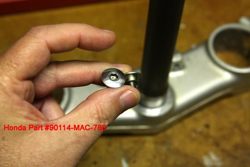

Regarding the steering stops using the CBR929/954 triple I thought I'd post the following pictures.
I like the kit with the drill bit included since it's much easier to get it right. I used a bit of 3 and 1 oil on the tap when cutting the threads then cleaned it up really well.
The picture near the beginning of the thread showed using allen bolts with lock nuts. To me, these give the steering much more range of motion with plenty of clearance. The part number is: #90114-MAC-780. Last digits are a little hard to read in pic.
I have three extra pairs of these I've taken off dirt bikes over the years if anyone wants to try them. Not perfect but free. Just pay shipping for a small bubble mailer.

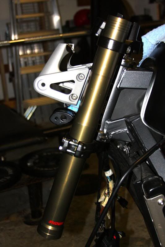

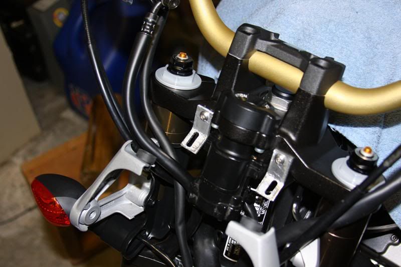

Running on fumes and working messed up shifts again. Time for a nap...... but first I slapped this together.
Here is a pic of the RC51 SP1 forks mocked up in the CB1000R clamps, and installed on the 919 frame. The fork shims I made work perfectly and everything installs like OEM. Also there are no issues with spacing/alignment and the clamp grip area lined up great allowing adjust ability if required.

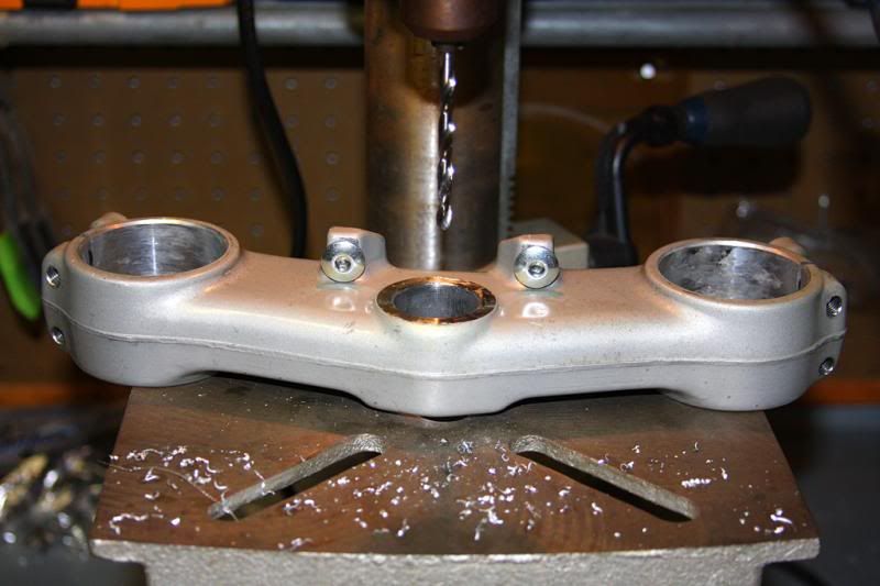

CBR954RR lower/CB1000R upper
Ok, I got my lower triple clamp all drilled up today despite my shoulder's objections.
The white caps on the headlight stay supports are Closet Maid shelving caps and can be found at Home Depot. They're there to make up for the difference between the 919 supports (6mm) and the CB1000R insulators 8mm inside diameter. I have automotive vacuum caps coming as these are a bit short (probably fine though).

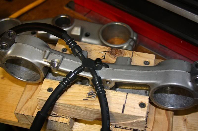

Steering stops.
Front brake line support.
If you will put a short straight edge across the front of the steering stops and measure back 11.5-12mm that will provide turn signal bracket clearance without the need to grind the bracket. We'll see if the headlight bracket is parallel to the forks as they are stock when I get it back from powder coating. My main concern was TS clearance. Regardless, check yours and just use this measurement as a starting point.
You then just mark for the supports side to side and start drilling. To that end, Ian (Helimech) suggested starting with a small bit and working up to the final size (3/8" is a nice tight fit) as it's pretty critical they be very close to the same. This definitely made me nervous. I started at 1/16" and used every bit in the set. Thank you for that advice Ian. Worked great as they ended up +/- 0.10mm of each other.
You'll need to cut off just a little of the two headlight stay support washers so they clear the steering stops during assembly but you can mark them as-is.
So, to update. I have all of my parts now as of the other day. Just need to mod up rear turn signal brackets/have them welded, send them to PC with the triple and rear wheel, have tire installed when they come back then assemble.

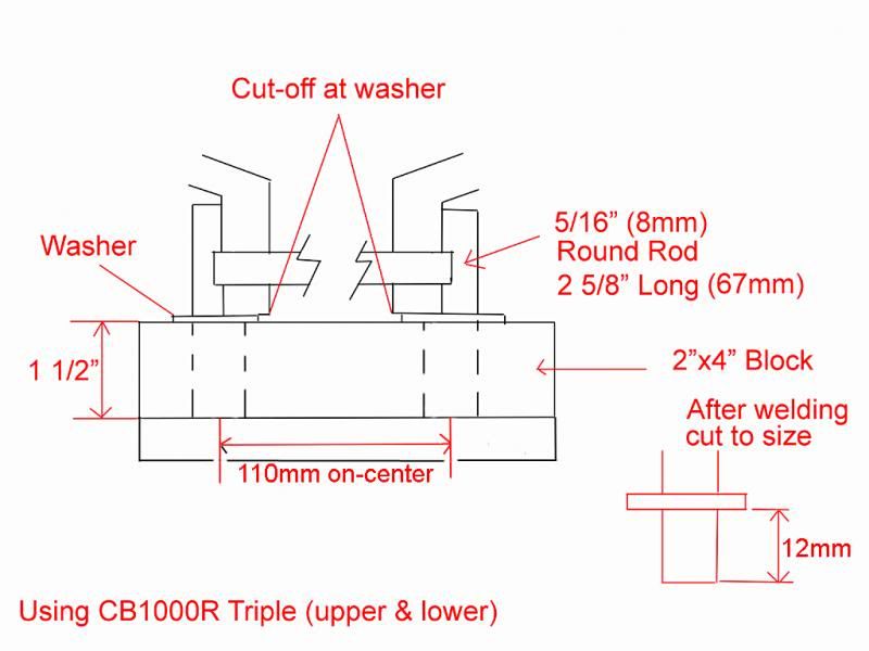

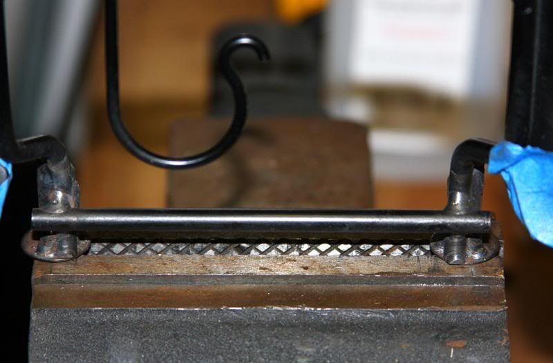

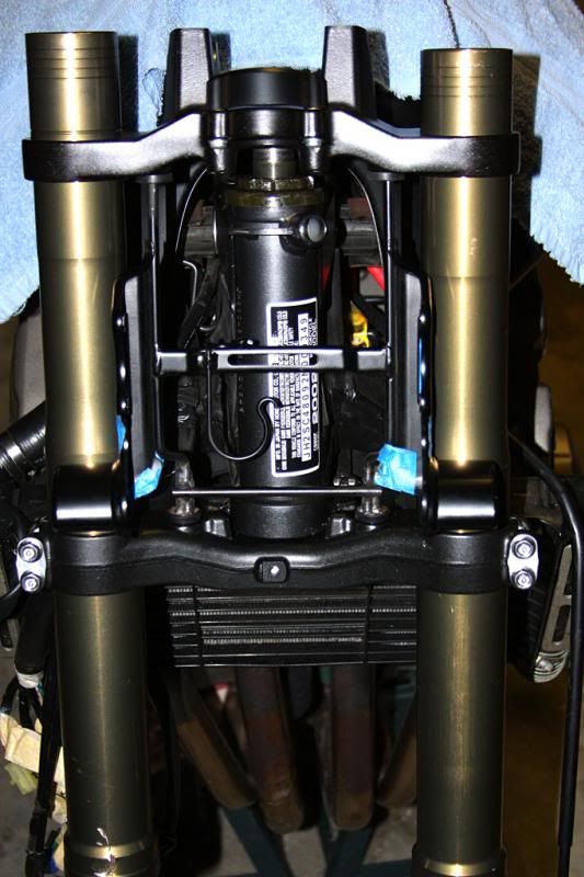

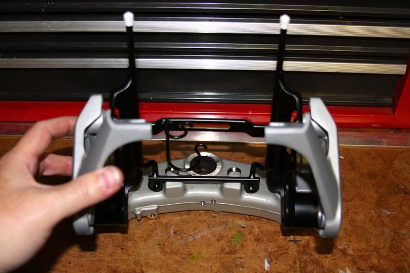

Headlight stay with CB1000R upper/lower triple clamps
As mentioned, the bottom supports have to be widened and, of course, the 919 supports are 6mm and the CB1000R insulators have 8mm ID insulators.
Here's the idea I came up with.
The 919 supports are centered from the front on the 8mm supports after cutting off the washers and the lower supports.
I used a simple jig made out a length of 2"x4", drilled thru at 110mm on-center with a 8mm (5/16") bit, then added a piece of 1"x4" on the bottom.
After welding it looks like this front/rear:
And on the bike:
The rear of the headlight brackets are nice and parallel to the forks as they are on stock 919's, however, the turn signal brackets are too close.
I will either cut them and move them forward by maybe 5-10mm or, more likely, I'll just grind some relief from the back of them.
Had I moved the headlight stay more forward, I wouldn't have kept the alignment of the headlight brackets. I was willing to make more work for myself.

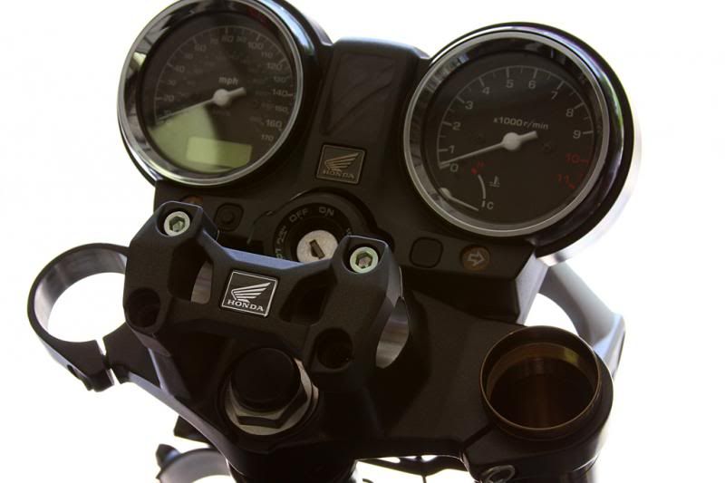

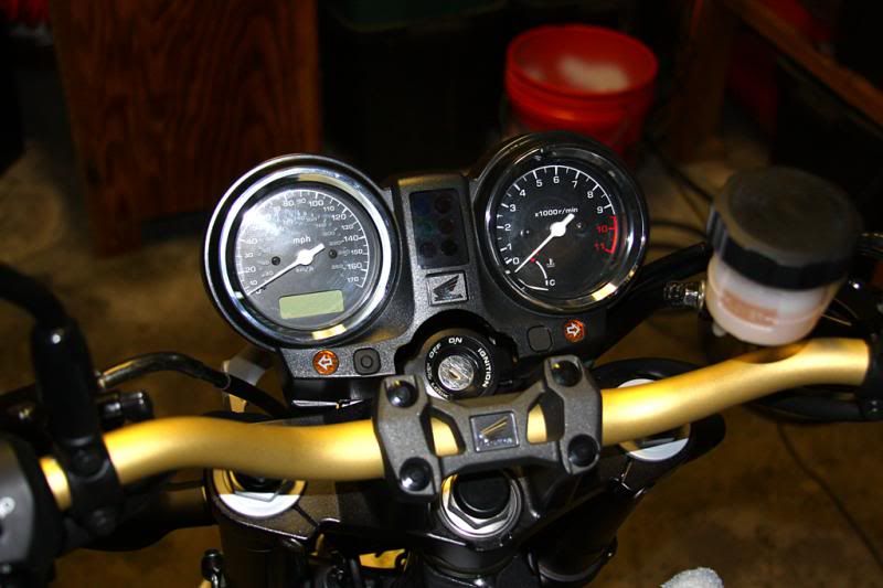

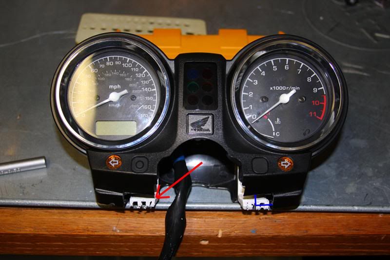

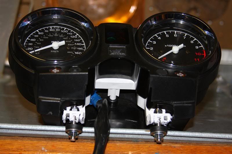

post #25 of 152 Old 06-08-2014, 04:02 PM Thread Starter
Originally Posted by HRC27 View Post
If you plain on using the stock guages with both CB1KR clamps, you will need to compensate for the fact the lower clamp is not straight, it rises and then goes to the forks. This has the effect of raising the headlight bracket bolt holes and the guages are no longer a friction fit.
You will need to shorten your headlight stay's lower supports to compensate for the triples rise. I didn't and will have to cut off the rear guage mounts and fashion some brackets. Not a big deal but more work.
Here's my fix. I made up a couple of brackets and attached them to the front of the upper triple. I made some mock-up brackets first to get the angle and where to drill before making these.
I cut the white 919 mounts back saving just the last level bit (red arrow). Then drilled for 6mm bolts (40mm long), nylock on top and then cut off the bolt heads. A little of the outer housing had to be cut back so it cleared my brackets (blue lines). I put three rubber washers between the white 919 portion and my brackets then Loctited the bottom nuts.
Finished gauges.
Bike is fully assembled now. Just need to bleed the front brakes. I'll try to get some pics tomorrow, it's raining off and on today (though I did sneak in a quick ride through the neighborhood).
post #26 of 152 Old 06-10-2014, 12:15 AM Thread Starter
The gauges were the last bit of fabrication for me. It just left me with the headlight and the bike is now complete.

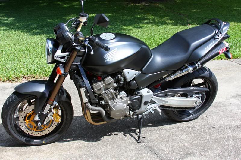

post #28 of 152 Old 07-22-2014, 08:14 PM Thread Starter
As you can tell, this thread is much shorter now. I asked Wes and MarylandMike to add things that we have confirmed to post #1 and make many deletions so that the thread is more concise for future readers. With something as technical as the RC51 fork swap, it will help them to not have to read over non-topic posts or items that didn't work out. Thank you.
post #29 of 152 Old 07-23-2014, 05:51 AM Thread Starter

post #34 of 152 Old 10-31-2014, 02:39 PM Thread Starter
Originally Posted by K1w1Boy View Post
That front end looks great, Robert, excellent job.
You must feel it was worth the effort?
For sure man. The forks and the Ohlins shock really work together great. Love it brother! Thank you.
