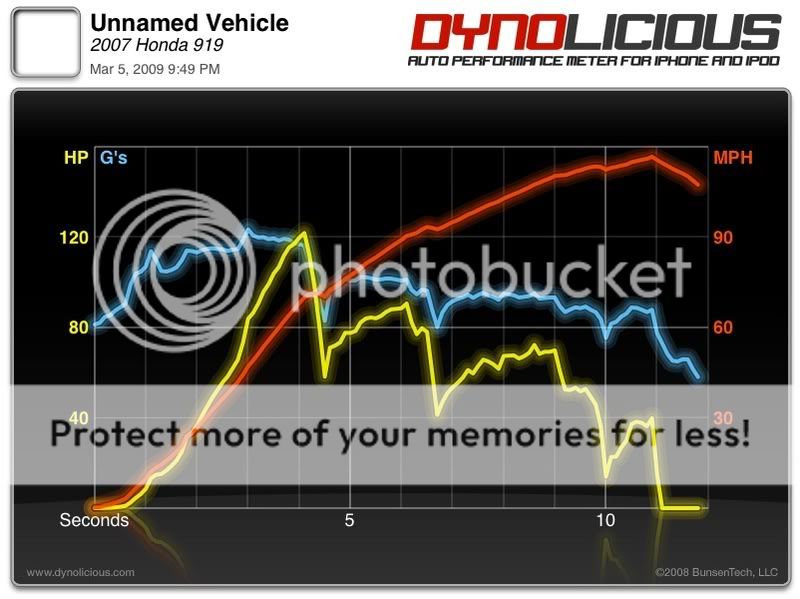

i started a new thread cause i know people are gonna nut up about this.......... so i took it off tk's thread and gave yall one to argue about......
the program was called "dynolicious" and it is sweet...
ok here is my bike setup...
17t front sprocket stock rear..
pc3 running the 003 map
k&n airfilter
tk919 designed and built ram air
downloaded and installed program.. calibrated it.. and then took a ride.. had iphone between legs on seat kinda sorta sittin on the back so it didnt fall off..
figured approx weight for bike and me.. 700ish which in reality the bike is 485ish.. i am 232ish... that is 717ish... if set it heavier it would have read higher horsepower..lol... (no cheating)
i had time to make 1 run.. here it is by the gps function... if you dont believe these numbers please feel free to pound sand up your butt...
0-60 3.72sec
0-100 7.73sec
60' 2.57
330' 5.43
1/8 7.85
1000 9.97
1/4 11.39
max speed 118.7
max accel 1.09g's
peak horsepower 122
now argue.... and that was with a 17t front sprocket...

I believe all of those numbers except the 0-60 time.
Is that the maximum calculated 0-60 or is that what you did during your ride?
Because apparently the 919 is below 3.0 stock.

That is actually what I ran... Real number... Bad launch couldn't keep the front down... Like I said couldn't throw my weight forward enough without loosing my phone....and remember 17t front t sprocket

122 hp out of a 919..... I don't think so.
post #22 of 87 Old 03-06-2009, 02:44 AM
It's not a real dyno...it's an Iphones EWAG of HP

Brian-can you set aside a some time next weekend? My job can go suck it--this is really important!
It really has to be Brian on his bike and then on my bike. Since dynos are plots of corrected hp/torque against RPM, there is no rider factor. But this is all calculated off of time-ALL rider factor. With my novice ass on them, my bike, Brian's, an RC51, a CBR1000RR are all going to have about the same estimated hp.
To prove this, anybody locally who has the RC51 or CBR1000RR please join Brian and I next weekend. This has NOTHING to do with me just wanting to ride these bikes-I am all about the science.
I can't wait to compare Brian on my bike and me on his and then watch you all howl when it shows the ram air actually removed hp!

I am going to question the weight you put in. You really need to find a way to measure the bike weight. 485 is the stock wet weight some magazine measured. Your bike is not stock. Switching to 900rr exhaust saved a bunch of weight. (I think somebody here measured the stock exhaust and his 900rr and it was about 20 lb different) Ideally, you should weigh yourself (with gear) and the bike. You probably got pretty close by rounding down to 700 but I bet you still guessed a little heavy. Also, how much gas did you have in the bike? 1 gallon of gas = about 6 lb. 4.5 gallons = about 27 lb. I'm not positive but I would guess the wet weight of 485 includes a full tank of gas.
The other thing I'm not sure about is the accuracy of the GPS. Does the iphone give you an accuracy on the location? The best way to correct for that is to do several runs and figure the average is about right. It would be acceptable to throw out a run if you know you messed up as a rider but not if you thought it was good run and the numbers didn't show it.
Comparing your bike to Nesty's is a great idea. I would be very interested to see the results. What kind of exhaust does Nesty have? Make sure you compensate for the weight difference in exhaust and have about the same amount of gas in the bikes. Keep up the good work, it makes for interesting reading.

Thanks Ridge! So 17% low ehhh, much better lower than higher! For a slower 4x mass car it will be more accurate than a fast bike...
Found this amazing head's up ap for pilots and note:
http://www.i-hud.com/iHUD_suite.html
The accelerometer used in the iPhone and iPod touch typically has ± 0.06g of offset per axis from the factory. This can be corrected out by using the "Advanced Calibration" option in iHUD settings.

Oops, I missed ridge's post while typing. Evidently it uses accelerometer and not GPS.

That's why it should be tested on the same bike, back to back only changing the airbox, even if the Numbers Themselves are high, the difference is what we really want to see.

All of the Dynolicious numbers are pure conjecture until compared to actual dynomometer numbers and done under controlled, verifiable conditions. Anyone can download this app. use it and post the numbers, but those numbers can not be physically verified by anyone but the person that took the readings. Just like statistics, the numbers can be fudged too easily.
Your comparisons have to be exactly identical in nearly every way. The accelerometer has to be fixed to the bike so that it cannot move at all. If there is any shift of the accelerometer, it will give false readings. Stuffing it between your legs (eww!) is not a good way to ensure it is fixed in place. Using a RAM mount made for the Iphone would be an ideal solution, as it is designed to keep the phone in place. Recording the runs on video with the conditions set, would be another good start.
Until then, all of this is hearsay.
