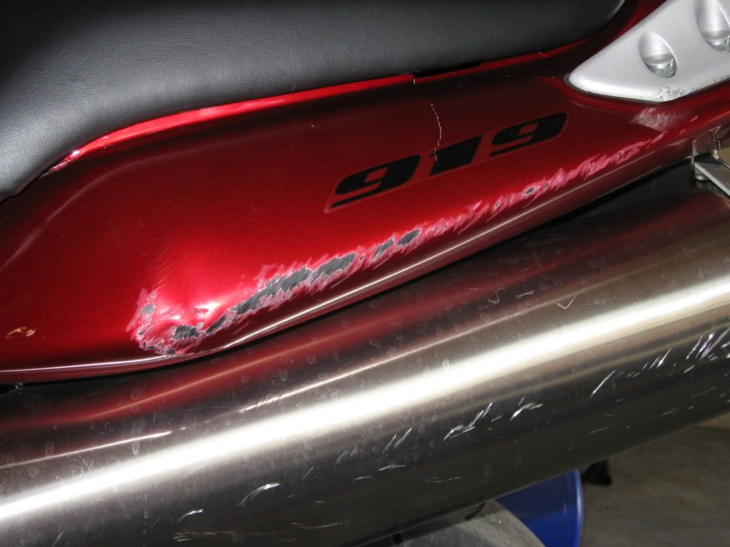

Went riding on Monday with some friends and crash my 919. I was riding pretty aggressively and went around a right hand corner and leaned her over pretty far. The rear brake lever caught the ground and got pull under the bike locking the rear brake on. The bike slid sideways and came to an abrupt stop launching me off the bike. Landed on my back about 10 feet away and slid to a stop. The bike slammed into the ground on its left side bending the handle bars and smashed the tail section. My gear took most of the impact so besides a bruised tail bone and a couple scraps I'm O.K. With the help of my friends I bent the brake lever back out from under the frame and rode the bike home.
Tail section

Very sorry to see/read that, and very glad you didn't get too hurt!
My brake lever use to hang lower (under pressure) until I tightened it. Did you comit the sin of touching it *during* the corner? Not bad damage. I hope you spiff it out soon and get back on the road. There are too many great rides there to enjoy!

glad your ok! amazing no tank damage with that kinda accident

BTW you might have scraped the rear brake lever, but I guarantee it didn't lock up the rear wheel by getting caught underneath the bike otherwise myself & many others would have been launched years ago
Sato Rearsets were ordered the very next day

The only reason I thought that I had caught the brake lever on the ground is the way it was bent and when we went to move the bike after the crash the rear brake was locked on and the brake lever was wedged under the frame. We had to bend it back out from under the frame to get the rear brake to release. I have dragged my brake lever a couple times before this but this time it just caught.

Sorry to hear about the accident and bike damage. You are a lucky individual, and should take some time to reflect on what caused the crash. Preventing it in the future would be to your benefit.
From your description, it sounds like you had too much lean angle on the bike, and not enough weight of yourself to the inside of the turn. If you are touching down hard parts on a standard, or sportbike, there is typically something incorrect about the rider's form. This is not always the case, it just happens often enough to warrant an examination.
Next time try sliding your butt off the seat towards the inside of the turn you are approaching. Point your inside shoulder, and knee towards the direction you want the bike to go, and try to kiss the mirror. Do not twist your midsection, this will also throw off the geometry of the turn. Act as if there is a titanium rod through your spine, and you can't twist or bend. If it is done correctly, the bike will do all the work in the corner, and you are just along for the ride.
Slow down on the street though. No need to be pushing that hard with so many dangers surrounding you. Practice the turns on a track, and your street riding will thank you.

is it possible you hit a slick spot? i don't really see the brake lever getting sucked downward in cornering, either in my mind's eye or by looking at your brake lever.
