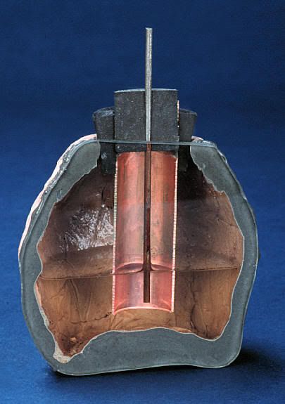

The first battery known, circa 250 BCE. Unearthed from a Bhagdad archeological dig amongst Sumerian artifacts. When filled with vinegar, it produces 1.1 volts. Use uncertain.

Rob, That is a neat old battery from Iraq, I wonder what their use for them back then was, an ignition source for their early bomb belts????
