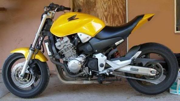

When I put this artist's concept of a streetfighter up as part of my signature it was just because it tickled me, and frankly it looked pretty good. I never expected the resopnse it's been getting!
Rather than instigate a whole bunch of threadjacks, here it is in all it's digital glory. Obviously it will need the lapels pressed in the exhaust, turn signal, reflectors, headlight, rear fender, license plate mounting (NOT STUCK ON THE FENDER IN FRONT OF THE TIRE!!), etcetera, areas, but it's not too far from an expression of what a naked bike should be, and the CB1000 isn't: simple and quite basic. No tricky bodywork, stylistic headlight treatments, odd scoop type things sprouting out of the tank, or any other chrome bits stuck here and there to satisfy the common misconception of the American market's preferences for wretched excess, whether it be a MotoGP wannabe or a Harley clone.
Remember this isn't an additive exercise, rather a reductionist, so if you would like to see a belly pan or fairing / windscreen or whatever else tacked on ... forget it. Buy one and tart it up all you want. The point is it's gotta look barely street legal, but satisfy all applicable requirements. I have a lot of ideas on how to make it work, but to all photoshop posessors: have at it, but remember the one unbreakable rule -- if it looks added on, it won't cut it!
This goes for the aftermarket addicts as well: everything will be engineered as an integrated package, so if it fits right in and makes itself at home, fine. otherwise ... well, you get the idea.
Packaging the electrics is my thing. It just need all the minds in this forum to give it the personal touch. If you come up with an idea post it and I'll try to draft it in, or do it yourself. Have fun with it.
Rob
If it has already been done, it is safe to assume it is possible to do it.
On the other hand, if it has not been done never assume it is impossible to do it.

Looks good Rob. Relocating all the electrical and shortening tail would take a little time, but definitely look good in the end. The short tail kind of reminds me of a Speed Triple.

I read the words 'barely legal' in your post and did a google image search - purely for research purposes you understand .............. hmmm not one motorcycle
Nice render - what's the plan for the pipes - dual sides underslung or a single high mount single muffler with twin outlets?
My only other question - where is all the electrics going to go - the 919 has very little under seat space now!
Oh and chop off those passenger pegs too.

Keep "Barely Legal" as your theme.
Keep the front end really clean. Maybe a bar end mirror and then use the mirror mounting holes for a pair of tiny LED turn signals.
Nothin shiny, keep metal surfaces the degree of polish of the original heat shields. Don't black everything out. Black is over done too many times.

Love it!!!!! The tail looks small and u'ber clean.

Nice...Ockham's Razor in action. Definitely needs your custom lanesplitter bars!

I know that standard, old-school (right-side up?) front forks aren't anywhere near as cool as today's hot-sh*t USD versions, but I've got to admit that they look really good on Rob's image above. My vote is for standard forks, but preferably with some real damping inside. I seem to remember Dan Kyle carrying the Ohlins non-USD forks in a 43mm diameter... Might be worth a try, except not with my photoshop skills.

Here's my take on what you started Rob... the shock area is an absolute mess, sorry but I was in a hurry...
I took your tank, seat, and rear section (lengthened just a touch), attached it to 9nineteen's bike (to get the inverted fork and 6-spoke wheels), then added a Bates dual headlight and a Yosh carbon can off an '08 CBR1000RR. I also added some black to the triples, headlight bracket, swingarm, and rearset plates.
Adding the black may have broken your rule, but I didn't add any bolt-on extras. I added the headlight to make it street legal, but did not add a license plate or rear signals.

To all who have contributed and who will contribute, please take note that I will seriously consider every suggestion, but will also be very critical of anything departing from the Barely Legal concept, and from looking as light as possible. Don't be discouraged if I don't jump on every bandwagon, but it must not look committee designed!
It is? Coulda fooled me. Nice work.
Lose the black. All of it. As it gets closer to finalized I may want some of it back, but for now ...
The front got way too bulky for my tastes, so out go the headlights and instruments -- I've got very specific plans for the front as regards those assemblies. Remember, amongst my specialities are electrical / electronics / optics, so I'll be configuring the street legal end of things, most of which will be cutting edge, and barely visible if at all.
Norton919:
Agreed, and reinforced by mdtoney's excellent work. Again, the USD forks unbalance the look too much toward the front, requiring the lengthened tail piece. With the lighter front, the tail comes out too much, just too bulky. It will have to be shortened, maybe further than I originally did. I have plans for the conventional forks: the spring in the slider with delrin stuffer tubes / oil lock travel limiters, and a pressurized shock cartridge in the stantion with a damper rod to the slider and an external reservoir hidden under the upper triple clamp. All adjustments will be at the top, and the damper fluid and fork lubrication fluid will be separate.
Mdtoney, could you do ma a favor? Since your abilities with photoshop far exceed mine, would you be willing to be the official artist? If so could you restore the original colors, replace the forks with stockers but keep the wheels, and get rid of the exhaust can (I'm thinking of a MotoGP style exhaust.)? That would give us a baseline to work from. I'd appreciate it.
REDROKR
rear-view camera mounted between gauges(nix the mirrors altogether) is my vision
Very tempting, and I've already done some work in that direction. Specifically, a 4" by 3" sealed screen between the handlebar clamps with a standard video overlay chip that will invert the video where speed, rpm, temp, whatever else will be displayed, enabling all the information you need without masking the rear view. I've seen this on fighter aircraft displays -- works beautifully. It will, however, be expensive. Such is life.
Nemo:
That's what started me thinking about this. How did you know? Great minds ...
barton664:
ok i took mdtoneys picture and added what i think it needs to be absolutly perfect... lots more horses
Where? Nice job hiding the nitrous bottle. Seriously, once Honda starts producing this, you are free to pump it up as much as you want. I think 120 at the rear wheel will do nicely.
Keep up the good work everyone!

fwiw, rob, crop the front edge of the front fender by 20%. etch out that rear
half fender thing. I like the open wheel look. the rest looks fine.

Here ya go Rob, Version 2.0.
Your tank/seat/rear with a standard fork, right side bar end mirror, no extra black added, no license plate, no turn signals, no headlight and no exhaust can.
Sorry I keep using your bike Roy, I don't remember who else has the 6-spoke wheels, and all of my stuff is still in boxes or at the powdercoater...

Awesome...wish I had/was able to use Photoshop. It occurs to me, however, that in the spirit of stripping things down to the bone, and since the streetfighter's seat has no passenger accomodations, that the passenger pegs could stand removing and the bracket cut down, as well.
I agree 100%, but the photo I found with the standard forks & 6-spoke wheels, also had the OEM rearsets. I didn't have the time (or patience) this afternoon to add aftermarket rearsets; that would then require digitally cleaning up the swingarm, chainguard/hugger & tire on the original photo to make it look right, since the OEM stuff is so much larger... Unfortunately, I'm kinda OCD when it comes to details and it would drive me nuts to add part of another photo and not have the time to make it look like the photos matched.
Hell, I spent a couple hours on the photo yesterday just trying to make the driveway and the garage door look like I didn't just slap a couple photos together.
If I have some time tomorrow I'll look around for a photo of some aftermarket rearsets, taken from the same angle, and see what I can do.
After looking at all the photos for a while, I'm starting to agree with Rob that the USD fork is a little too much for this bike when you use a smaller seat & rear section. Maybe I can find a photo of a 900RR swingarm and start over with the inverted forks and the small rear section.
Anyone want to take on that project in real-life? Adding a bulkier swingarm and linkage shock? Come on, it can't be that hard to fab up some shock mounts...
Here ya go.
This is not a photoshop job: I rolled my bike out, unbolted the left footpeg bracket and took another picture with it out of the way, then imported the image into Paint, isolated the swingarm, scaled it down to 93% and pasted over my original image, eliminating the bracket. Then I drew a Q&D rearset bracket and used Paste From to call up the original image to copy the footrest and shifter, cleaned it up and pasted it onto the drawn bracket, and used the line function to draw in the link rod. The point is there is more than one way to skin a cat! Have at it guys and gals. I'm heading out to Telluride for a week of R&R and forgetting about the hellacious stress I'm under, and probably won't be near a computer much less an internet connection for at least the next four days. Enjoy!
Rob
P.S.: The line you see on the swingarm just at the rear of the rearset is not an artifact of the paste -- it's the weld joining the cast part of the swingarm to the extruded part.
------- Rob --------
