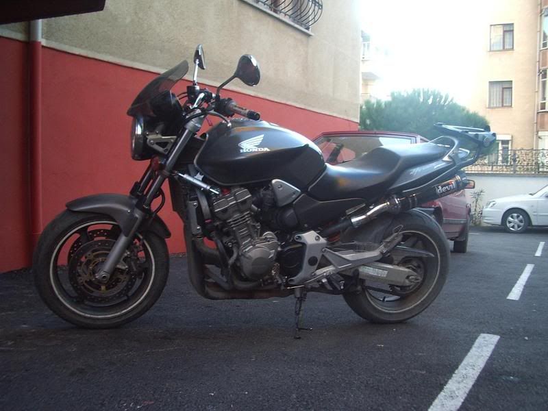

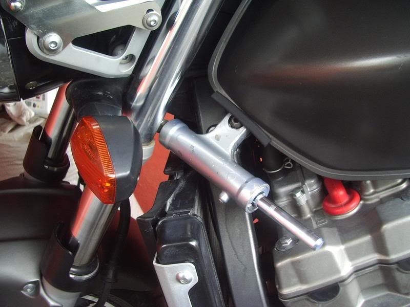

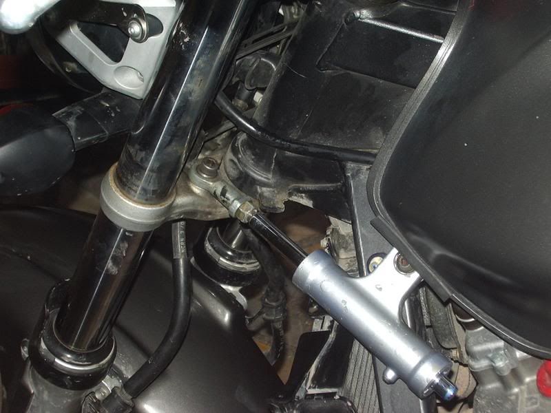

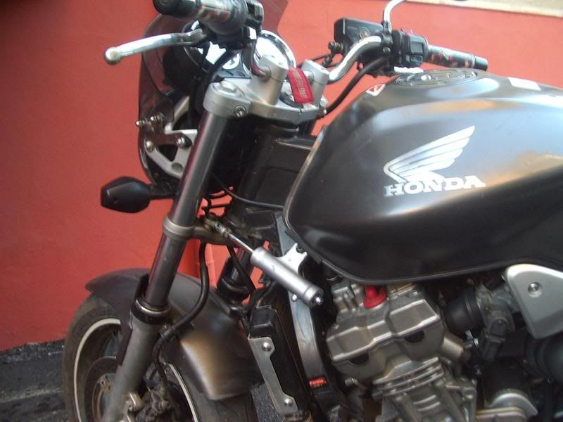

Hi... Today i finished the whole steering damper search and got my damper installed...
As most of the damper are too expensive for my standarts i needed a cheaper solution... After searching the net and local suppliers i've found out the oem dampers for old GSXR bikes (up to year 98) and found a site where a member installed these dampers on his 919...
Here is the site and my 919 after last modifications...
http://www.fireblades.org/forums/hon...ng-damper.html
Forgive me about the dirt it was a rainy day...
rangermania is offline

I really like how that damper is attached lower on the fork where it's needed.
However you should attach a safety cap to the rod's end or risk getting a skewered during an accident.
dream is offline

Some answers for your concerns...
First reactions for most onlookers are about the rod and getting skewered...But in my opinion the ones attached on handle bars carry greater risk on that subject and i can't figure a way to put some tap...
I've ran trhough whole GSXR forums before deciding to try this and every body says the factory out damper is nice but it comes with 2W oil inside which is so thin and needs to change with 10W... But it is so easy to change oil on this part... You just release the allien screw off pour the oil out and put back the new while pushing forward and back to get all air out and you are ready to go... After promptly doing early wheelie touchdowns and corners on rough pavement i am convinced it works great and does not bother me on rush hours... Also since i am not in to track racing there is no need to pay
400 $
