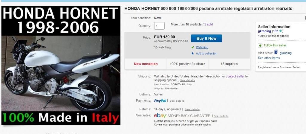

I want to change for the looks mainly and maybe move up and back a bit for a better tuck. I would cut up a stock set however they stockers are going on ebay for just enough $$$ that it would be silly to buy when a little more would buy a set of nice race ones.
I found a set from Italy that look promising, sell for 139 Euros but they wanted 59 Euros to ship WTF? The seller is looking to see if there might be a cheaper shipping option.
