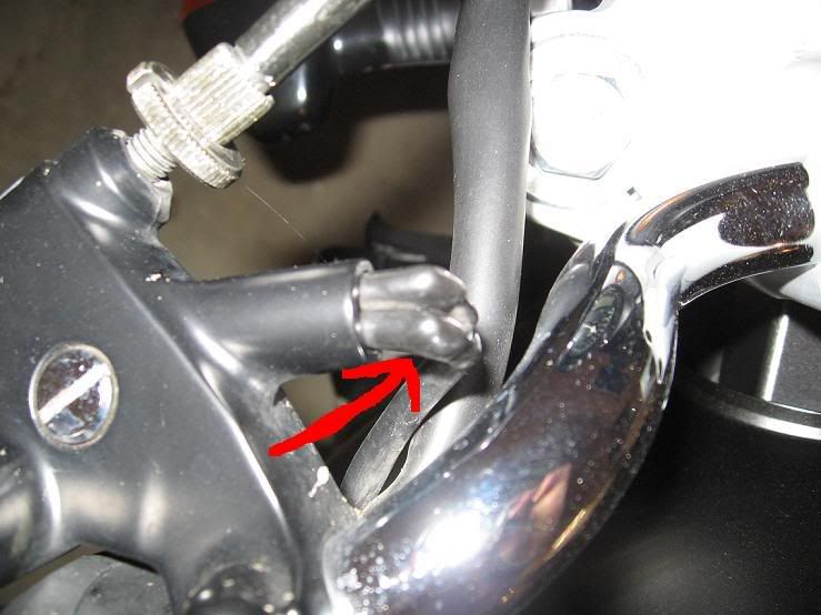

If I am not mistaken, here's a pic of the switches in discussion:
motorwerks919 is offline
post #8 of 19 Old 11-26-2006, 01:38 PM Thread Starter
Posts: 10,286
Yep, that's it. Remove the wires, push on the end with the terminals and the switch will move left of picture once the screw is removed and the clutch lever is pulled away.
Then get down on your hands and knees and look for a black cylinder about the size of a cigarette filter.
OR you could hold your hand under the hole where you removed the clutch lever and maybe be lucky enough to catch it on the way down!
