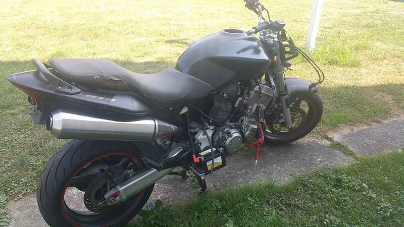

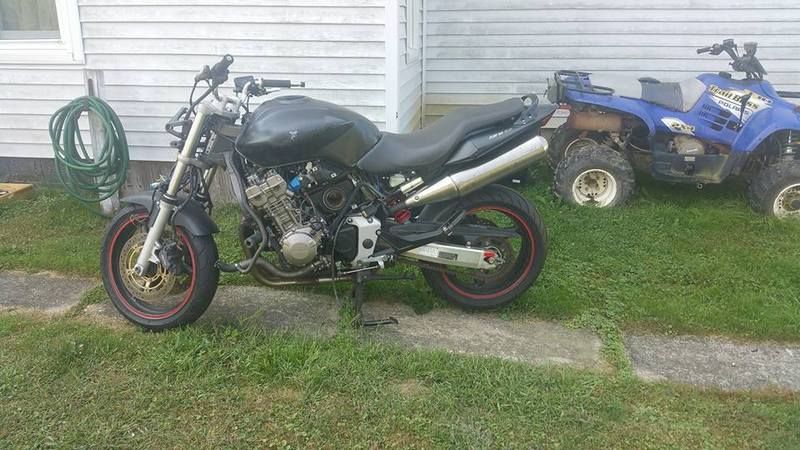

Here is the bike when I picked it up...

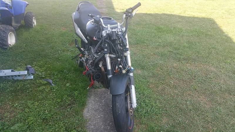

Then I got it home to do some inspection to it.

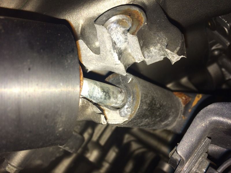

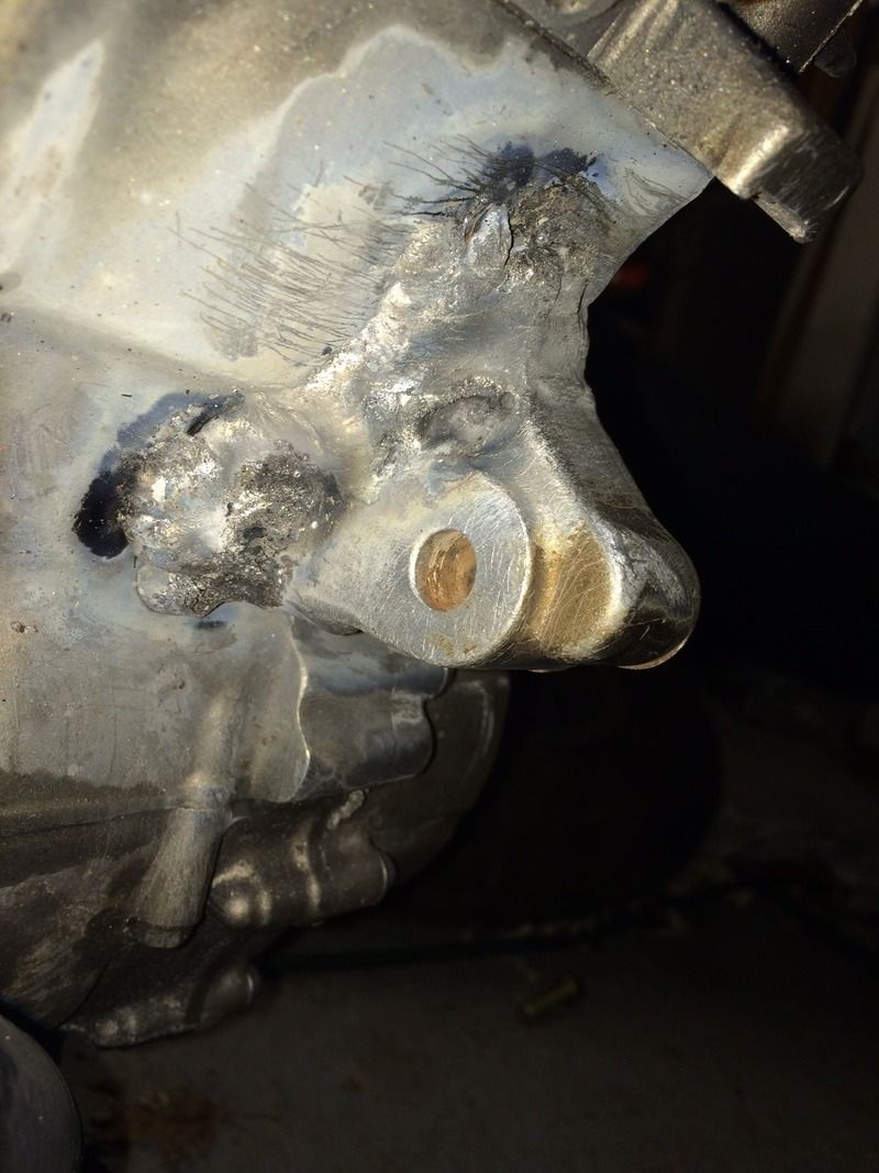

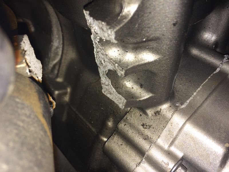

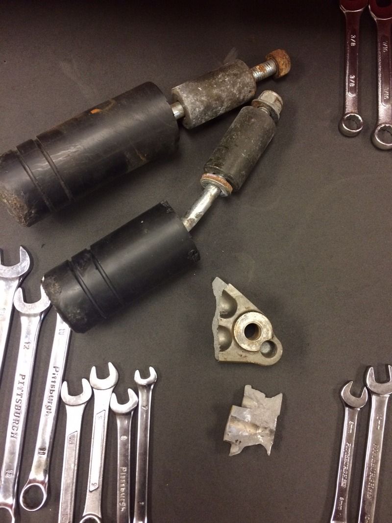

Broken front mounts from the sliders...

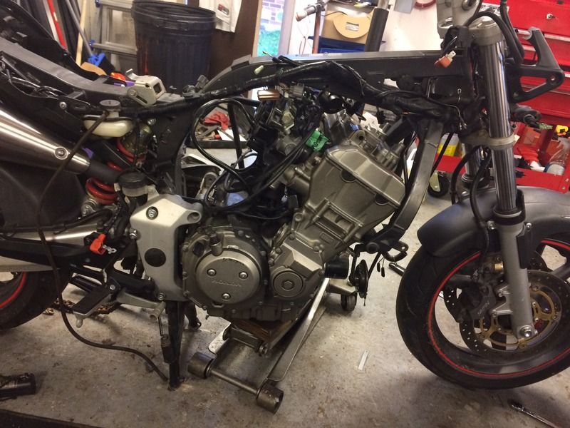

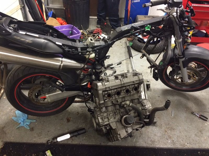

Well you can't ride anything without front engine mounts... so time to drop the engine...
Funny thing happened... I could get it out without using a persuader (rubber mallet) to beat off the air box. So, I'm in the market for one now...

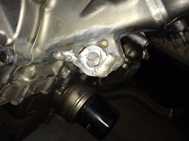

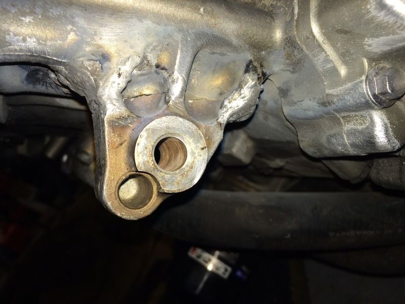

I sent that down to a welder buddy of mine and he was able to TIG the mounts back together. I will be submitting more photos of that tonight. Cost me about $70 bucks for that. I need to grind them down and drill them out again but honestly it looks like that may have fixed it.

Yep, you're in for some fun! For future reference, removal of the airbox doesn't require a mallet....but a 3' prybar sure helped. I used a 2x4 to protect the valve cover.

When you drop the engine the air box has to come out though right? I was having a hell of a time finding any info about it. Also, the air box has a screw under the frame, no screw driver will find its way in there and the same thing on the screw that is recessed in the air box. Do all have a strategy for getting that one out before dropping the engine or does it all come down together?

Engine mounts welded in
Well $70 bucks later I've got material to mount to now. I need to grind them down a bit and make them a little more presentable but after a single drill out they should be good to go.

Damn google! https://goo.gl/photos/zTii5wW9NgB4Xvv28 should work. Air box came out before the engine. I don't remember how I got to them, but I am certain I didn't break the air box to remove it. I'll have to push my 919 out later to refresh my memory of what you are talking about. I have several options for removing screws in hard to reach places, as I've fought with crap like this more than once so it may have just been a matter of tooling.
