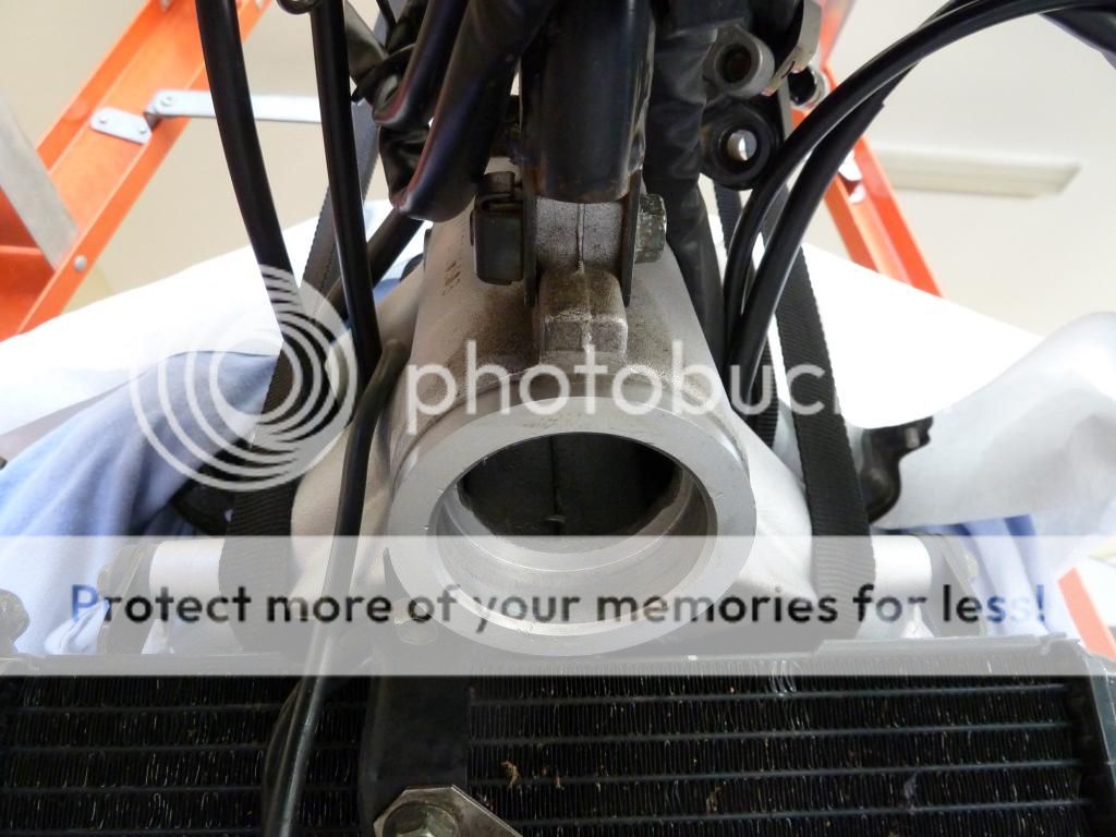

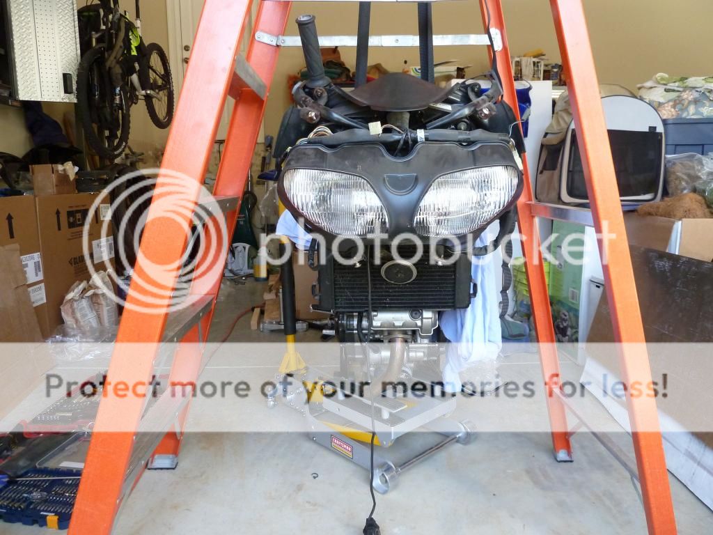

Here's the poor bike, already stripped down and suspended so I could remove the triples:
Please ignore the mess....I'm working on it!
Top and bottom of head tube with races removed:

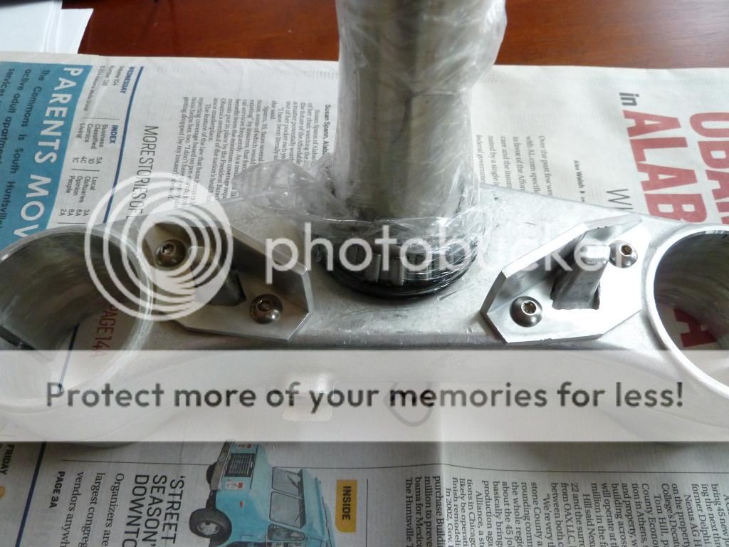

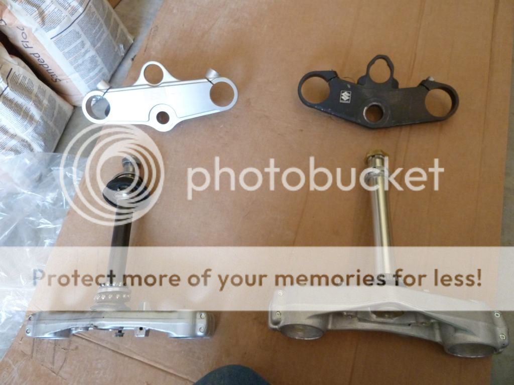

Old SV triples left, new GSXR triples on the right:
The new triples are over 2.5 lbs lighter than the old ones!

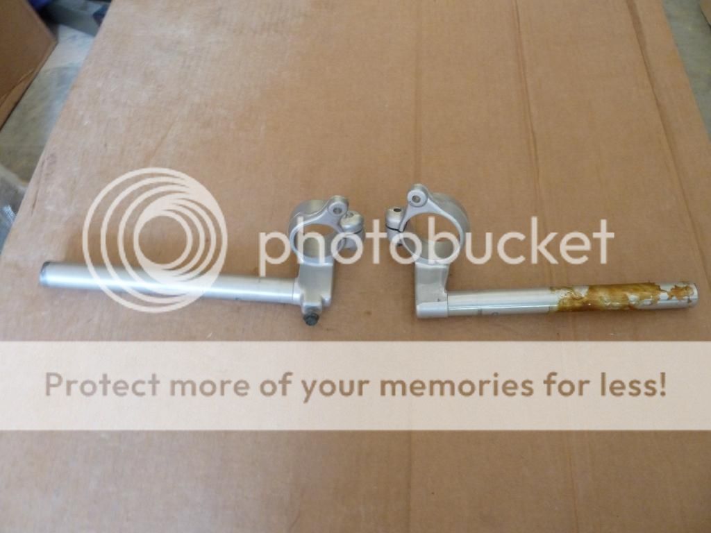

Old SV clip-on next to TL1000 clip-on:
I originally bought GSXR clip-ons, but they didn't sit high enough.

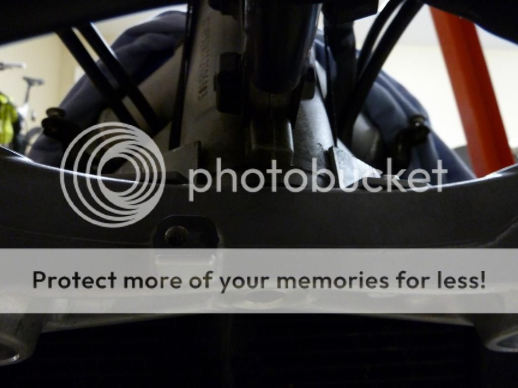

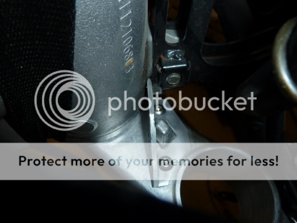

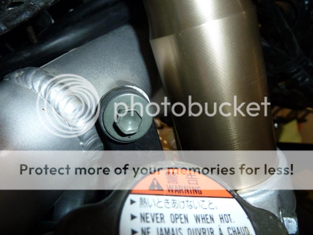

My work over this past weekend: custom steering stops! They're not pretty, but they work :P
Installed on the bike:
In action:

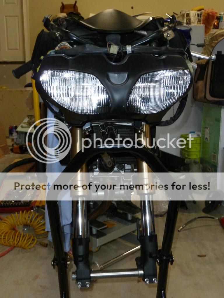

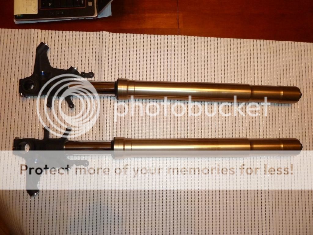

Here are the forks that will be installed, maybe tomorrow. '07 GSXR 600:

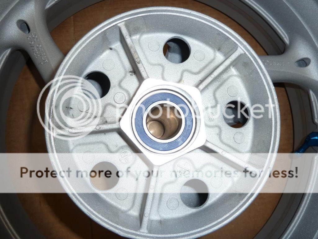

And, finally the wheels. They are at the powdercoater to get a silver finish similar to the OEM SV wheels. They were in great shape, but it would've just been too much blue to use them as is!

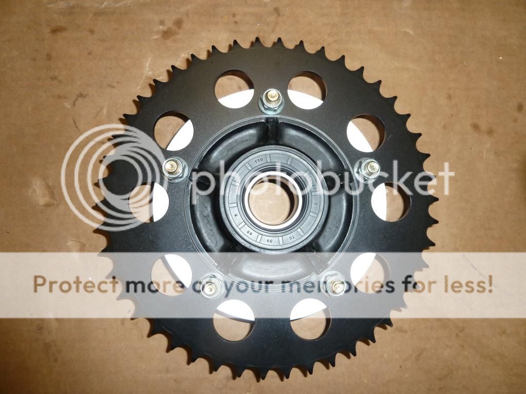

Yes, I'm putting the GSXR rear wheel on the SV, thanks to some help from TWF Racing.

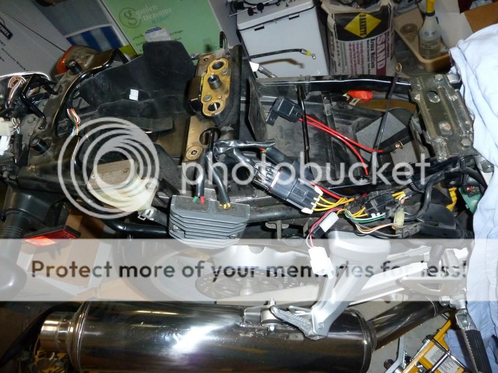

I'm also updating the voltage regulator (R/R) thanks to an iffy OEM unit. Switching it out for a MOSFET unit off a CBR600RR. Now I just need to find some Yamaha parts to round out the composition of this bike

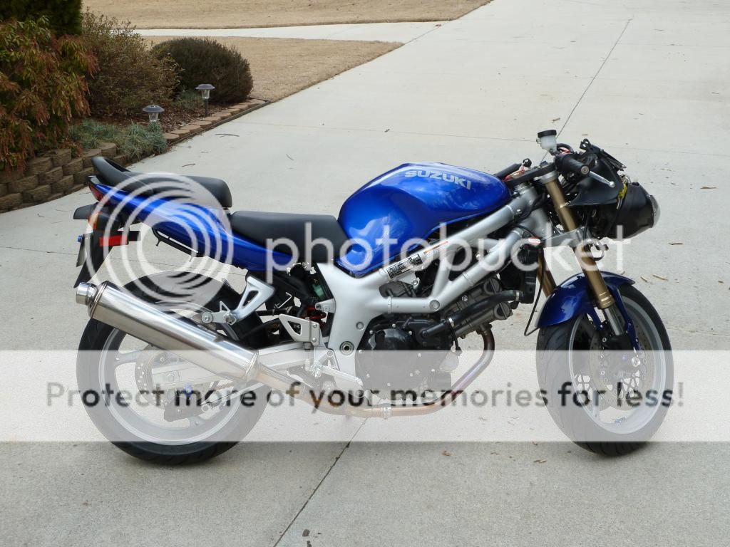

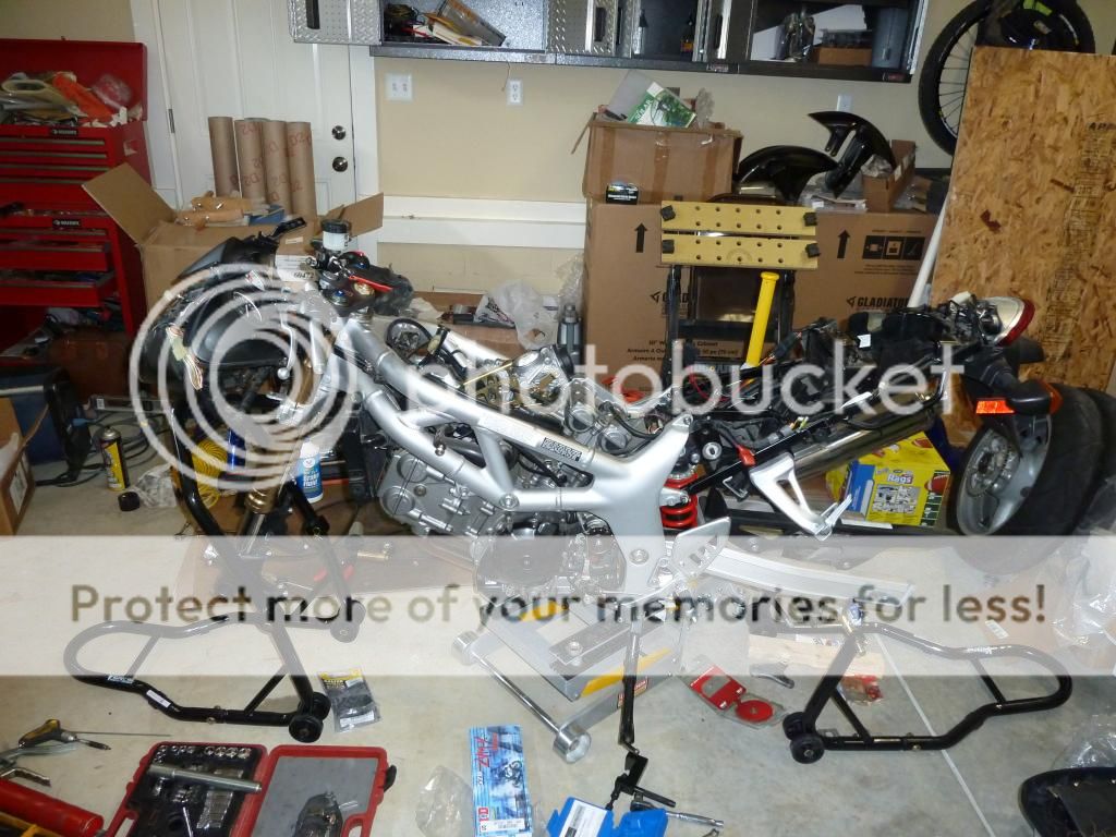

A little progress today since I'm sitting at home

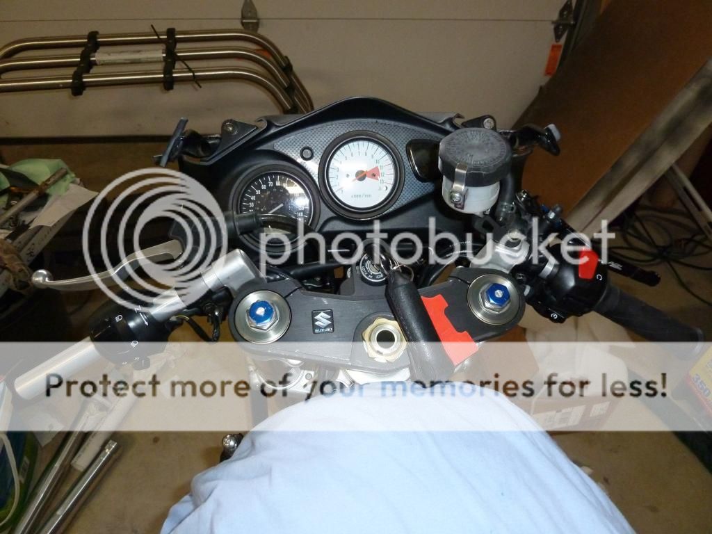

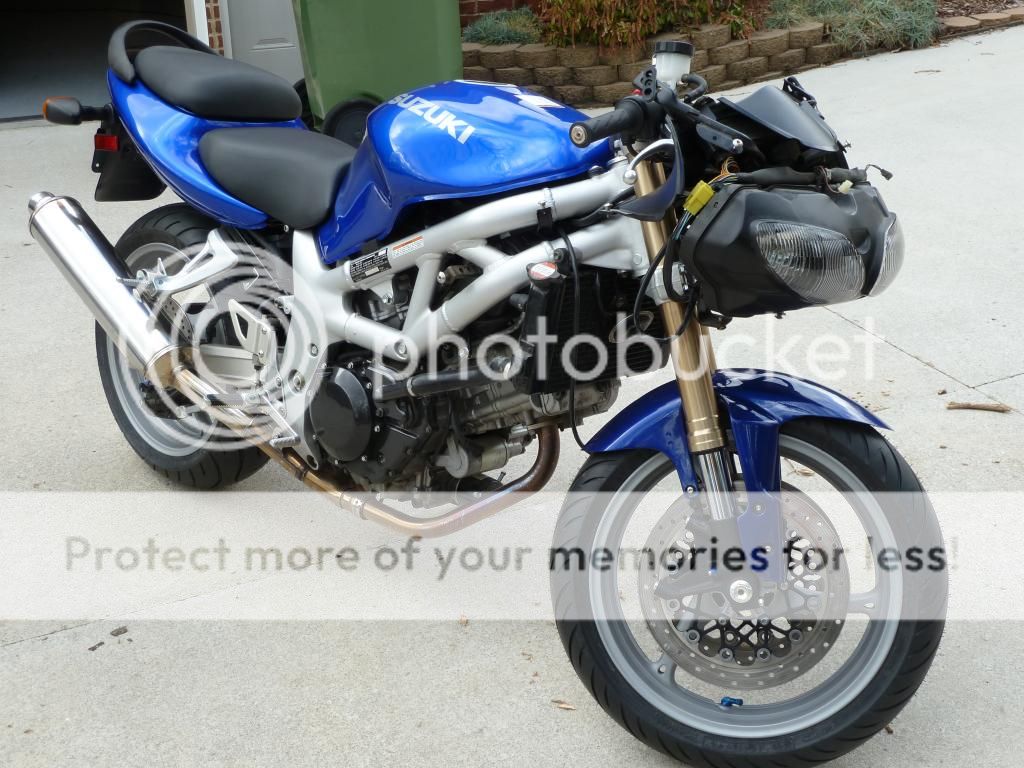

I have the top triple, clip-ons, and forks mounted now
I have a GSXR clutch perch I'm going to put on; the SV perch doesn't leave enough room for the controls on the new clip-ons. Plus, I want to be able to buy matching levers anyway. I already have a Pazzo brake lever I got for cheap on ebay; I didn't realize that they only sell them in pairs, so have been on the hunt for a matching clutch lever for the last couple of months. Buying some cheap CNC levers on ebay to do the job in the meantime.

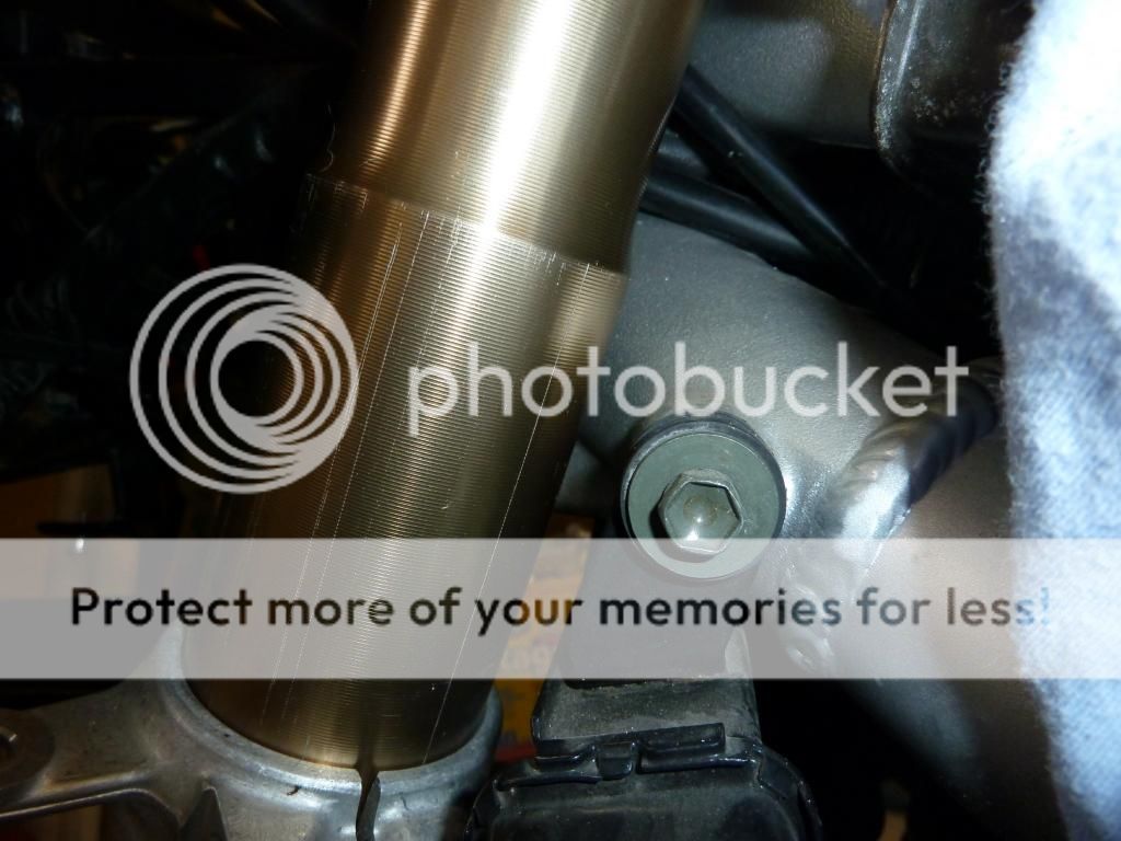

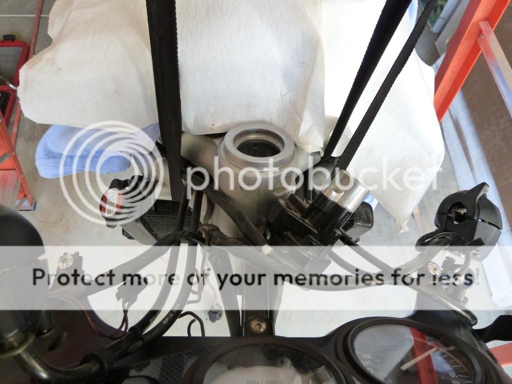

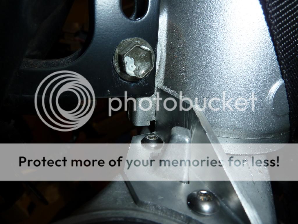

I got my steering stops pretty close to where I wanted them to be. Here is the point on each side where the forks come closest to hitting (top radiator mounts):
Left
Right
Still plenty of room before the clip-ons hit the tank. I need to shave just a little off the left stop to allow the steering lock to work...I can almost engage it.

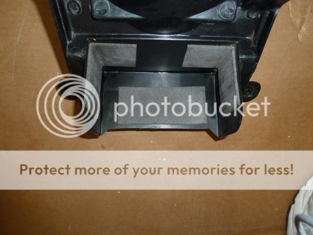

I have a black plastic front fender that came with the forks that I was going to paint, but looking at paint prices, it will probably be cheaper to find the right color fender on ebay. I'm thinking that, or carbon-fiber wrap the one I have, because I doubt I can get a close enough match to the Suzuki blue to make the Mrs. happy...it has to be right!
More to come. I should have wheels this week!

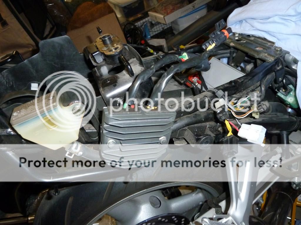

Electrical
Slow day here, so even though electrical stuff isn't that exciting, I'll give an update on where I got to last night

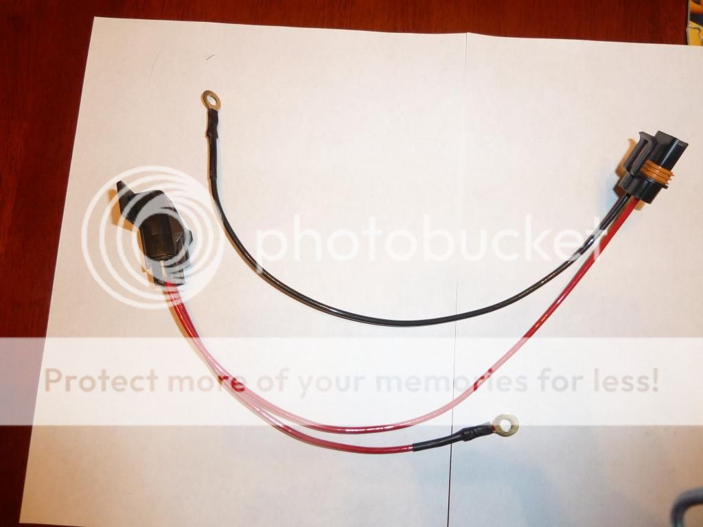

In general, the first gen SVs have a couple of issues with the charging system. The first, which I didn't mention in my original post, is the gauge of the wire in the wiring harness coming from the R/R, and the length of it's path before it ever reaches the battery. To give an idea of this, here's a shot of the wiring harness connectors that plug into the stock R/R:
16 gauge at best; I haven't cut it to verify.
The solution, which I've seen posted on several sites, is to not connect the R/R output to the wiring harness, and instead have it go directly to the battery using 12 gauge wire. Using recommendations from SVrider, I bought all of the connectors from Eastern Beaver and made a harness that plugs into the output of my new R/R and goes directly to the battery (fused). With the larger gauge and the short run it should be much more efficient. Here's what it looks like:
The black lead will go directly to the battery, and the red goes through a 30A fuse (the covered connector to the left in the pic).

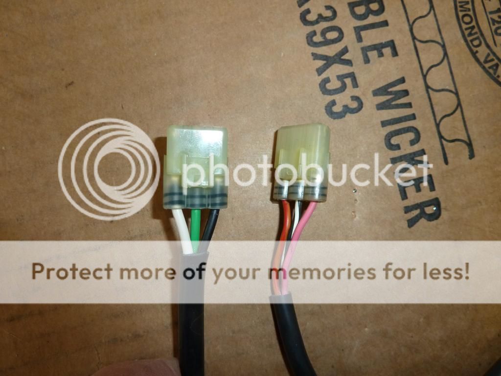

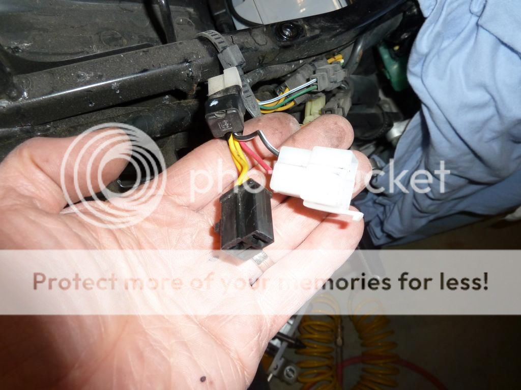

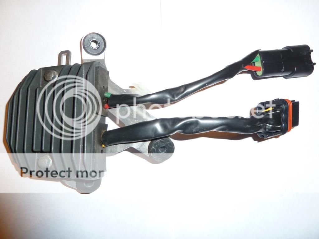

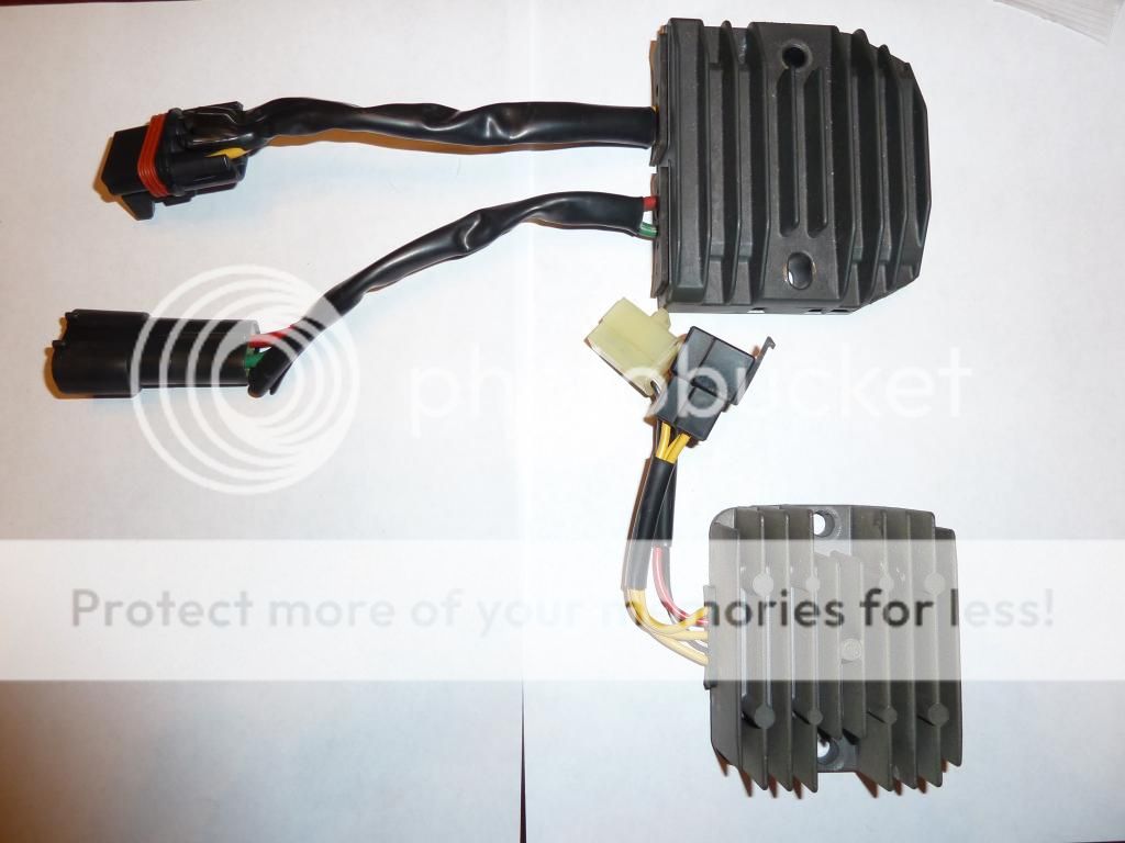

The second issue is the R/R itself. Over time, the first gen R/R has been known to fail. It's not a very efficient unit and generates a bit of heat; I'm guessing that is a large factor in the failures. While ours is still good, I'm going to replace it now so that it doesn't leave us stranded later. Based on a little reading, it seems the FH008 unit from a CBR600RR is an excellent replacement unit. I got one on ebay for a decent price:
Next to the OEM unit:
In the pic, I've already cut off the connectors from the new unit and installed water resistant connectors. Another good thing about using this model as a replacement: it bolts right up to frame just like the stock unit
With everything connected, but minus the battery
The wiring harness R/R connection is still hanging there. I'm just going to tape it up for now and tie it to the frame.
Superdog is online now

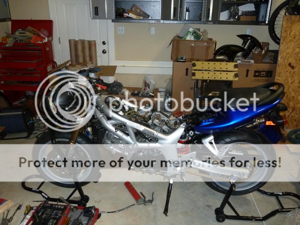

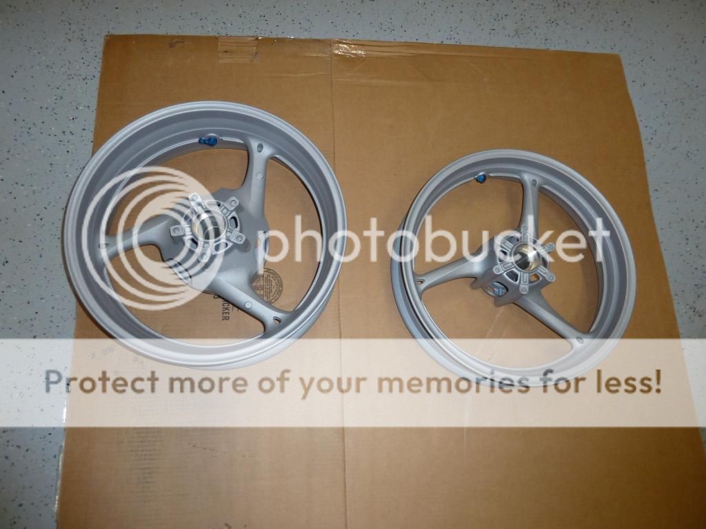

Wheels!

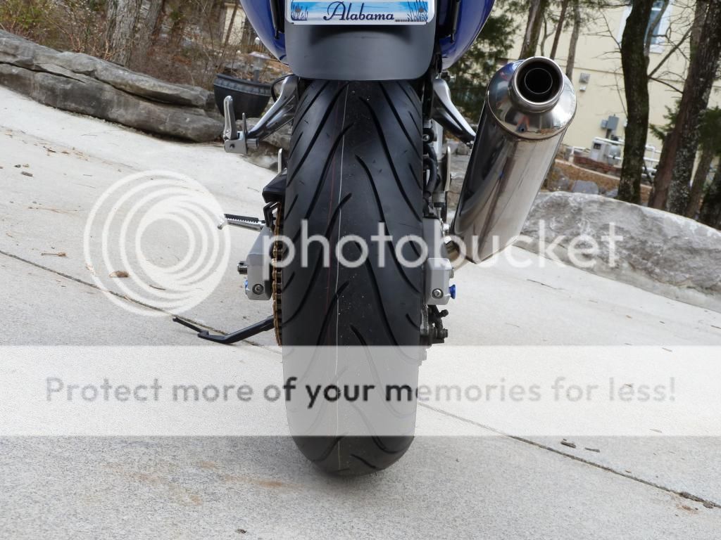

Finally have them back. I couldn't get exactly the color I was looking for, but I think they'll look okay on the bike. Unfortunately the PC guy didn't listen very well when I explained where not to coat it, so I'm having to do a little cleanup
Almost ready for bearings/tires:
I picked up the blue 90 degree valve stems from Heli a while back (thanks again!); I think they'll be a good compliment once everything goes back together

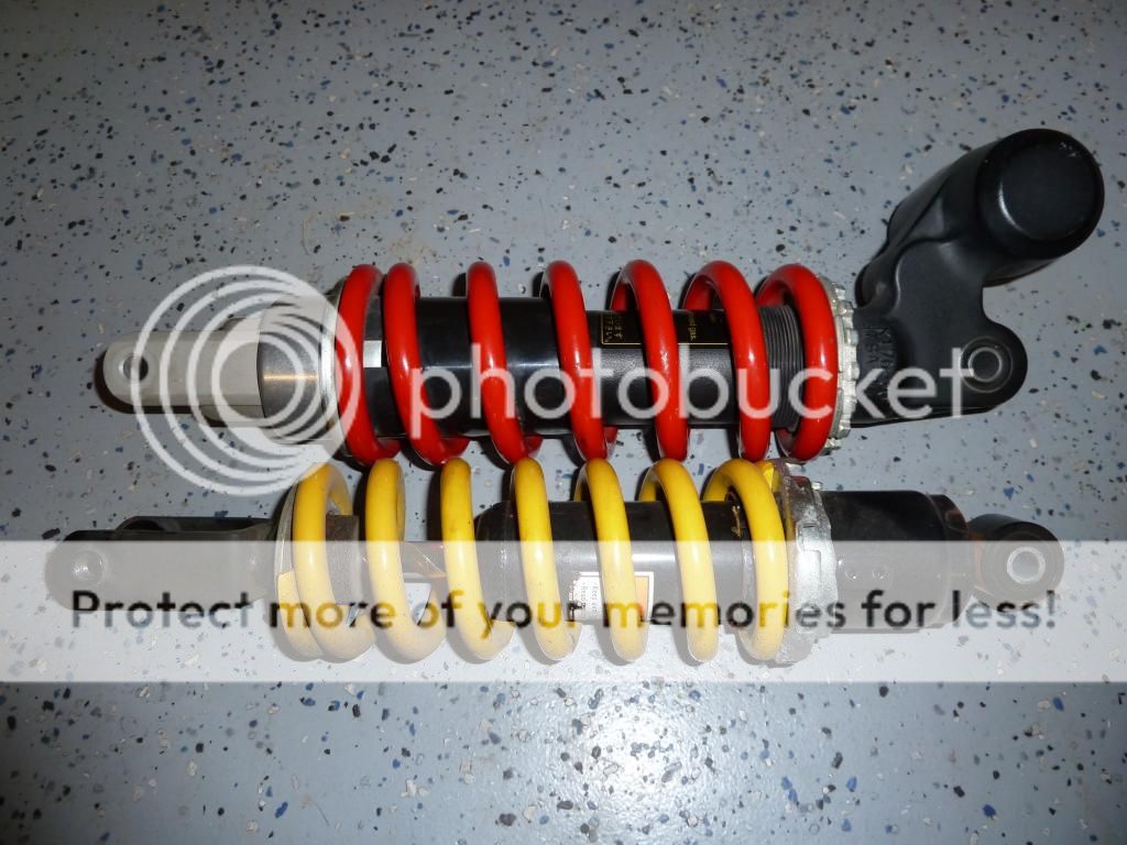

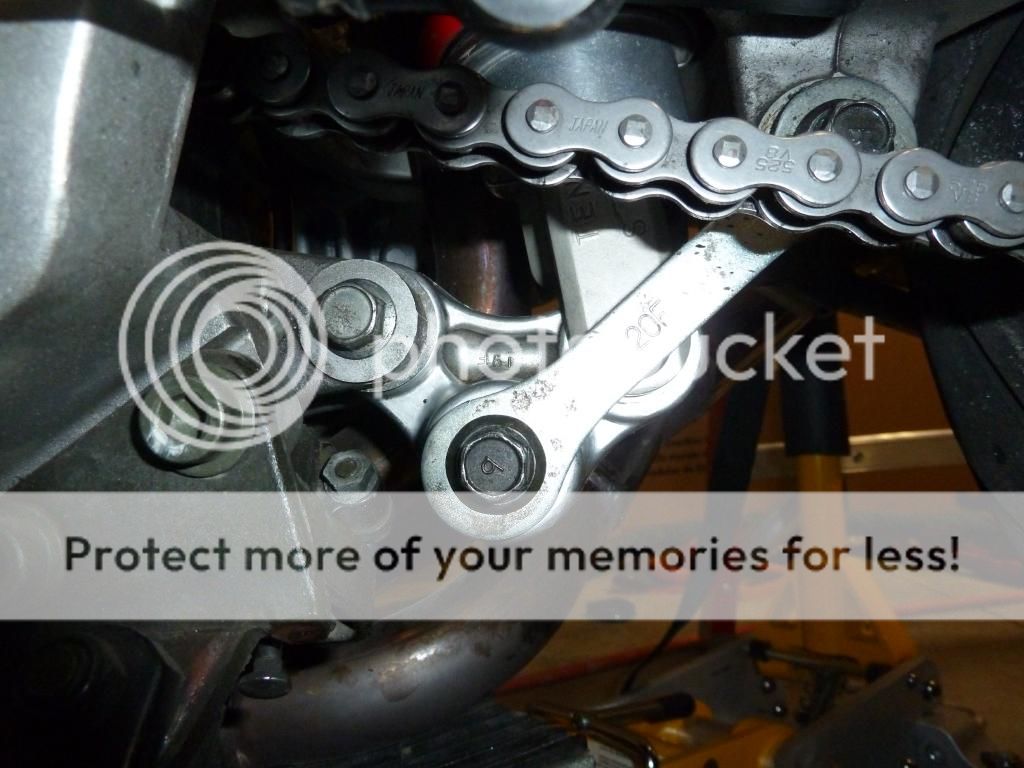

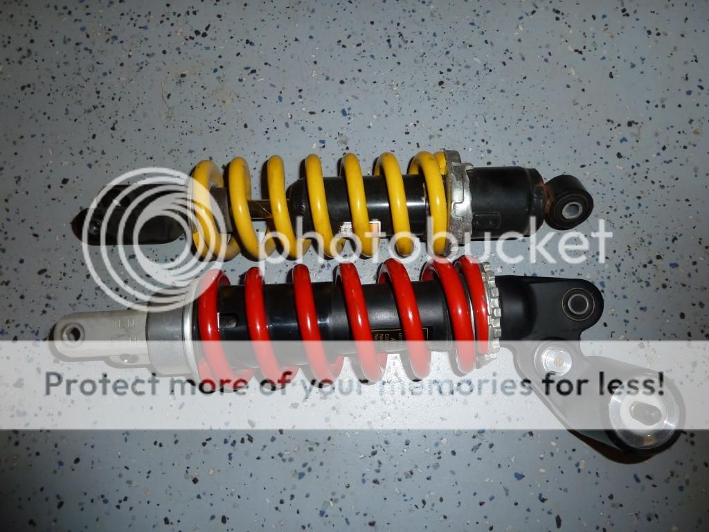

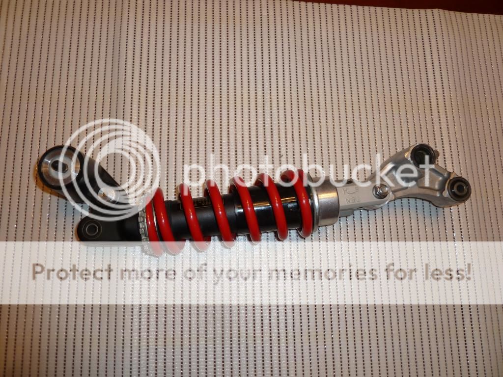

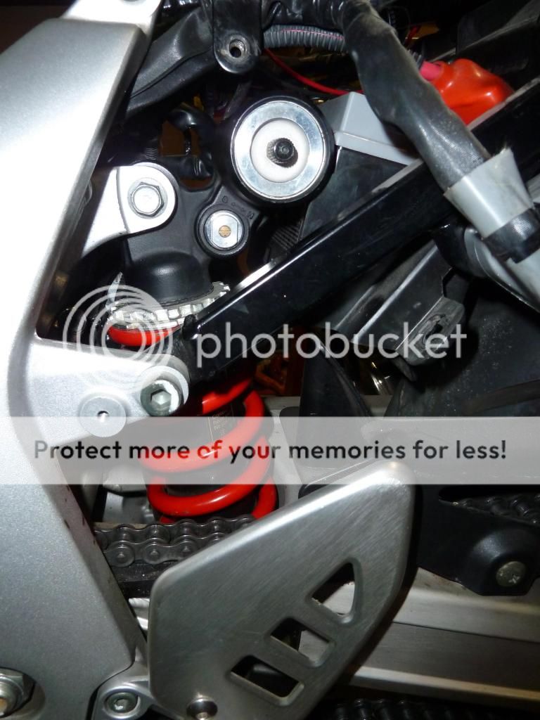

I spent an evening last week installing the Kawi shock. It's a worthwhile upgrade if on a budget (I think I paid $40 shipped).
The Kawasaki shock (from a 636) has the red spring, the stock SV is the yellow:
Notice any difference? Yuck. And you think the 919 shock is bad? lol

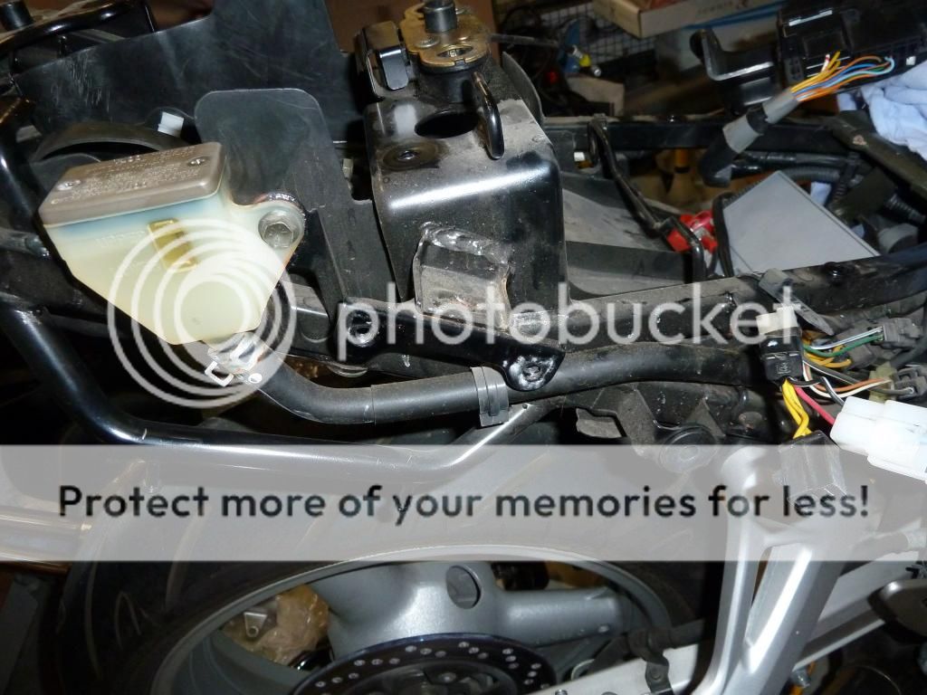

New(er) shock mounted. The reservoir and the battery are trying to use the same real estate....
I've got to push the battery box back a bit to make space.
I've got the bolts, and just need to finish making spacers to hold it back out of the way. I'm considering getting a lithium battery to give me more space to work with.
While I had it apart, I pulled the sleeves out of the suspension linkage and forced new grease into the needle bearings. Also cleaned up the whole assembly; it was black from road grime, grease, etc. Nice and pretty for now

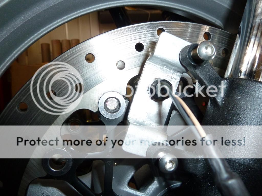

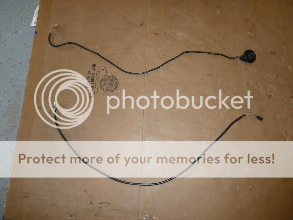

Speed sensor

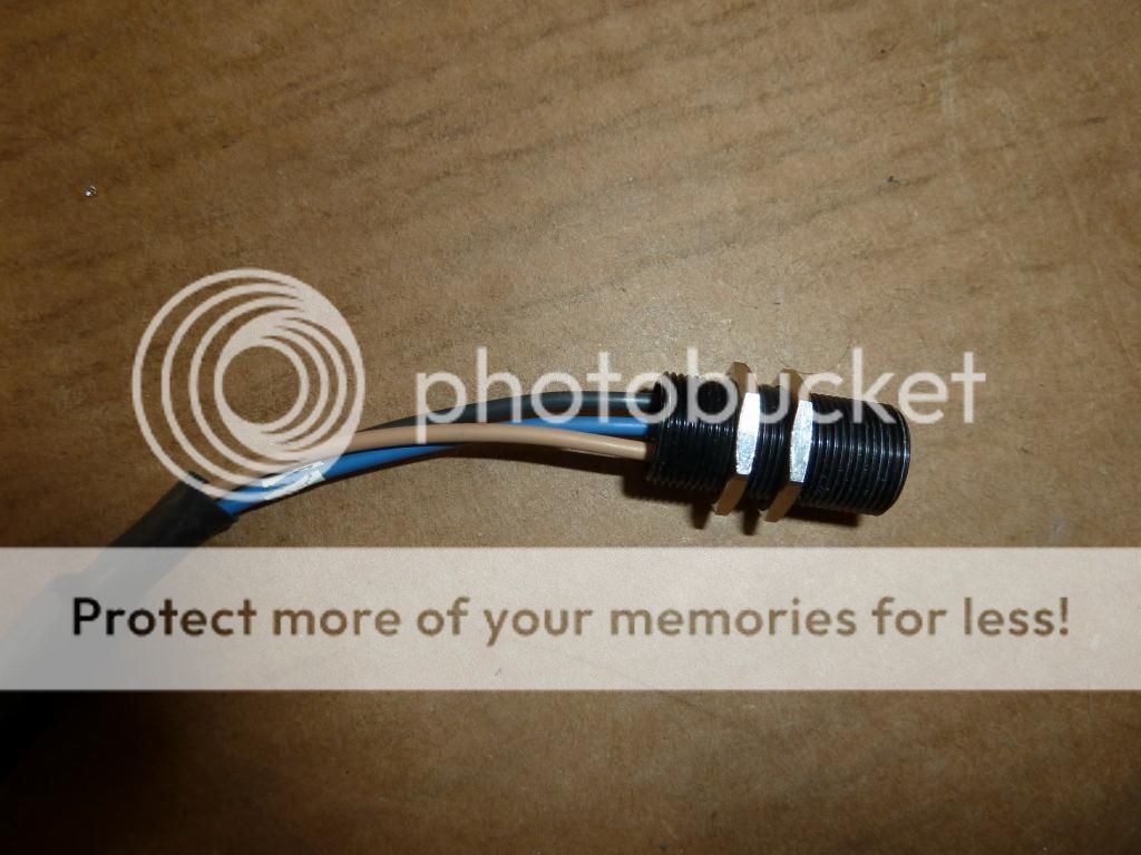

The SV OEM speed sensor is mounted on the front axle, and reads a ferrous cylinder, driven by the front hub, that provides 4 pulses per revolution. I found the solution on svrider, which is to fasten 4 strong magnets to the front brake rotor, 90 degrees apart, then mount a sensor on the fork leg such that it can register them as the wheel turns. There are 12 buttons on my rotors, so I used JBweld to hold a rare-earth magnet in every third hole.
I got the hall effect sensor from Newark electronics. For the cable to connect to the bikes harness, I bought the proper connector from Eastern Beaver, and made my own out of a light duty, grounded power cord I had laying around I just didn't like the idea of cutting the stock cable off of the old sensor. Plus, this way maybe I can get some money for the OEM unit on ebay
And mounted, using my special, custom made, hall effect sensor bracket
Amazing what you can do with a torch, a hammer, and a vice
Front view; you've got to get it pretty close to have it read right
Fortunately, the front fender will hide this when it's mounted.
It seems to work based on a quick test, though I won't know that it is right until I get it on the road and have something to compare it to.

Pretty self explanatory. The rims got all new bearings, and I got the PR2s mounted. I did the tires just using spoons and rim protectors. It wasn't as hard as I though it'd be.
Getting the bearing out of the sprocket carrier was tough, but I'm glad I got it replaced. No idea how many miles the original had, so best for peace of mind.
Really naked:
Looks better with wheels/tires:
As you can see in the pic, I got the 520 chain installed too. Yes, I'm not organized...
I had to modify the battery box to not interfere with the shock protector (not really a hugger, so not sure what to call it). It was rubbing right at the front of the box, just past the edge of the battery.
Before:
After:
I tried to cut only as much as I had to. This gave me the clearance I needed.

All I've got left to do is finish installing and bleeding the front brakes, and button her up and I'm done. Should be on the road this weekend, weather permitting
The only reason the brakes aren't done yet is the place I bought my Galfer lines from sent me a Gen2 SV650 kit. For some reason, the Gen1 has a different thread pitch for the MC banjo bolt. I got a slight refund, but had to source the proper banjo, which I just received.
Here's how she currently stands, on her own two wheels
Now has a 180 rear tire (thanks to the GSXR rear rim). Quite a difference from the stock 160!
It fits and has the necessary clearance, but not by a lot!
It's going to feel like a completely different bike. Hopefully in a good way!

Wife and I took a ride yesterday, after getting the sag set. Overall she likes the upgrade
She did give some good feedback on things I need to tweak (compression is a little firm, turn-in is slower). I took it for a spin afterwards and agree, so will be playing with it today.
Also learned that the speed sensor appears to be reading all of the rotor buttons, so reading extremely high. Oops!
Attachment 51809
Sorry for the bad pic. Didn't realize how much sun glare there was.

post #35 of 50 Old 03-09-2014, 10:06 AM Thread Starter
Posts: 1,364
Oops, here's the pic.

Attachment 51833
Nice job, she looks great!

Moved the speed sensor out another 5 mm or so, and now it reads correctly.

Try and pick up the edge of the rotor button with the sensor, if you use the ceneter of the button it counts the void and really throws things out of whack.
post #39 of 50 Old 03-12-2014, 05:22 PM Thread Starter
Posts: 1,364
Thanks! My goal was to actually just pick up the magnets in every third button, and not the buttons themselves. Just had to get the distance right, and it seems to be right now.
I guess with a speedo-healer I could have just used all of the buttons and not worried about the magnets....but I'm cheap!

post #40 of 50 Old 03-20-2014, 08:15 PM
Does the bike now turn in slower with the 180?
