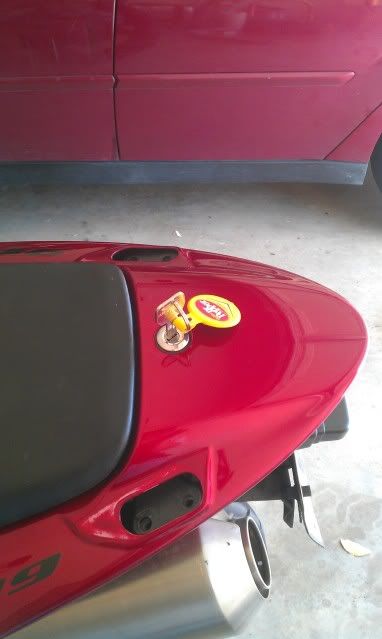

Help! My key is stuck in my seat lock.
Any thoughts on how I can free it?
I was taking the tail off in order to remove my GIVI rack. I noticed that the key was stuck, so like a complete dunce, I put the seat on to see if it would come out.
It didn't.

Did you remove the tail and reinstall it before putting the seat back on? If so I know what your problem is -- when the tail was reinstalled the latch arm ended up on the wrong side of the lock arm, jamming it.
To remove the seat all you need to do is remove the taillight lens and the right side bulb. Once the socket is empty twist it with a large flat bladed screwdriver until it releases, push it out of the way, and using a bent piece of coat hanger hook around the latch arm and pull while turning the key to release the seat. See picture taken from the seat side of the tail (I'm too lazy to remove the taillight lens). Notice the latch arm is behind the lock arm. That's where it should be. Yours is almost certainly in front of the arm.

This was exactly the problem. Unfortunately, I discovered what I had done wrong while I was standing in the parking lot of the Honda shop.
I texted Parts Guy at the same time I made this thread, and like always, he suggested I bring it up to the shop. Reluctantly, I agreed.
Since I had the grab handle removed, I could see the latch mechanism by peering through the holes in the tail. One of the service guys poked a screwdriver through the holes and activated the seat latch. We then removed the seat with ease. As the service guy and I were messing with the key, I realized that the lock arm was on the wrong side of the latch arm. All we had to do was pop the tail off and reseat it.
