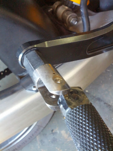

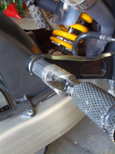

Having trouble lowering the passenger pegs. Tried removing all of the bolts from the passenger pegs to extend them for passengers, no luck. I am assuming I have to hammer out the very small pin (which is the only thing remaining that could be holding it) to release it. I was wanting confirmation from someone who has owned a pair of these before I try and force the issue/break them.
Thanks
(Bolts are still in for pics)
I've had this problem...let me go jack with it and I'll BRB. I'm wanting to say there is a detent thats siezed.

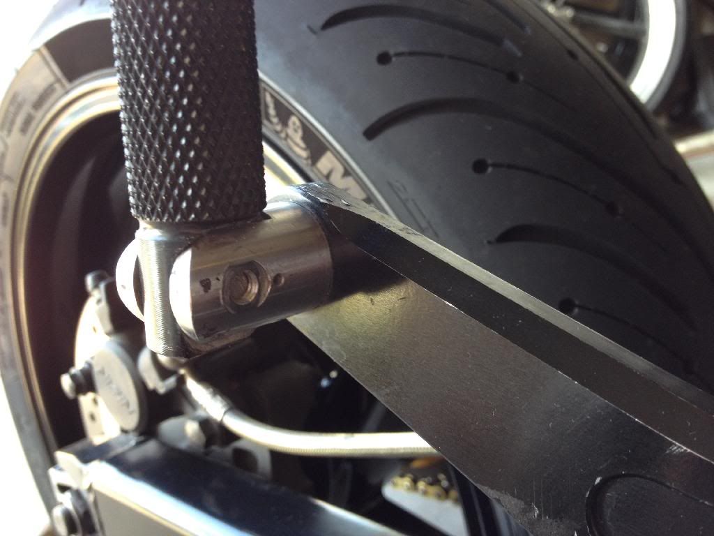

DO NOT DRIVE OUT THAT "PIN"! Pics on the way. In the mean time, spray lube in the pinhole from both sides.
post #4 of 20 Old 03-30-2014, 09:50 AM
What I thought was a detent in the rear appears to be the end of the mounting bolt. However there are detents on the top and bottom that seat in the pinholes. I believe I hit it up with penetrating lube and a cheater after taking the pivot bolt out. I'm pretty sure the detents are spring loaded so you may want to skip taking out the pivot bolt. Mine didn't pop loose, but are quite dry and likely stuck.

There is no pin in those small holes. Just a couple balls with a spring between them.
Spray some lube in there...

Lube Fixed It
Sure enough, drowned it in wd40 and pulled down. I now have working passenger pegs!

I sprayed it down with triflow and freed it the next day. I then proceeded to take it apart which I ended up destroying the spring.

I was on the phone with Sato earlier, buddy was telling me that none of their passenger pegs use springs. I had to send him pics. Waiting to see if I can get springs directly from them...
