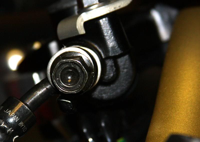

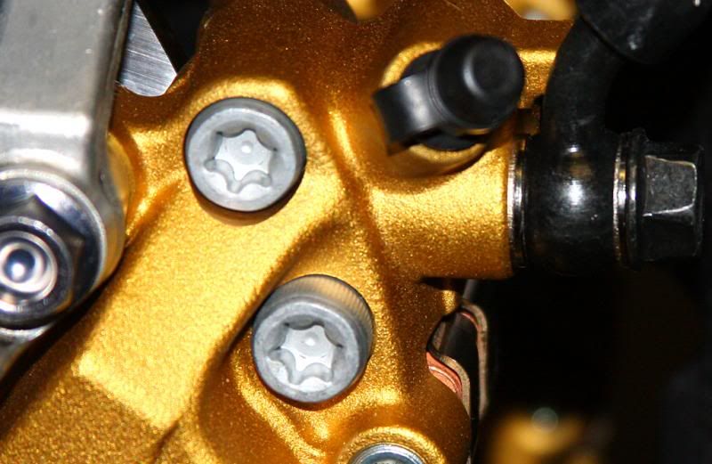

Problem
Ok, while trying to bleed them through both methods, I had no luck. I decided to check my install and found a problem.
First, if you look at the bango bolt and crush washers on the caliper, everything is nice and aligned and looks correct.
Now, look at the master cylinders bango bolt/washers. Clearly, the M/C stop is pushing up on the washers and I could feel where there was a slight leak. I didn't check to confirm they were correct. They were from the original owner who had purchased a bunch of new front brake parts.
Do you think they are the wrong ones? They look too dang big to me. Would you order the known correct bolt/washers or just see if Autozone had some copper ones in the right size?
Thank you.

Those look larger than expected. I wonder if they are even crush washers to begin with.
You could reuse your original washers from the 919. Or just take them to Autozone & ask them to match them.
I ordered these last week & they worked perfectly on the GSXR, all the same on the Honda & should work just fine.
Amazon.com: Earl's 177101ERL 10mm Copper Crush Washers Pkg of 10: Automotive

I actually ordered the OE ones listed for the 954 from Rocky Mtn last night. I had used a clean but used bolt so I have one of them coming too. RM is not the best on price but their shipping is really fast.
