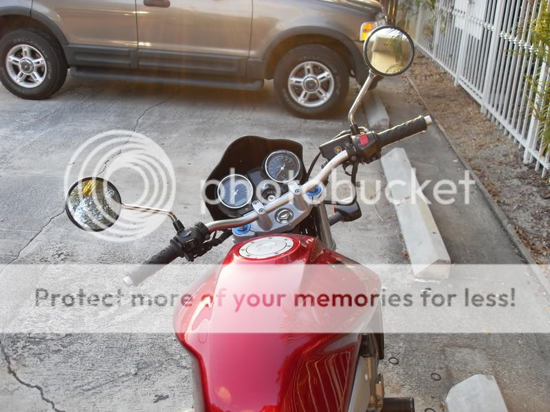

before... renthal u/l's with stock mirrors... if you notice the ends i have about 3/4 in. between end of the grips and the bars.. i like them that way... i have big hands..

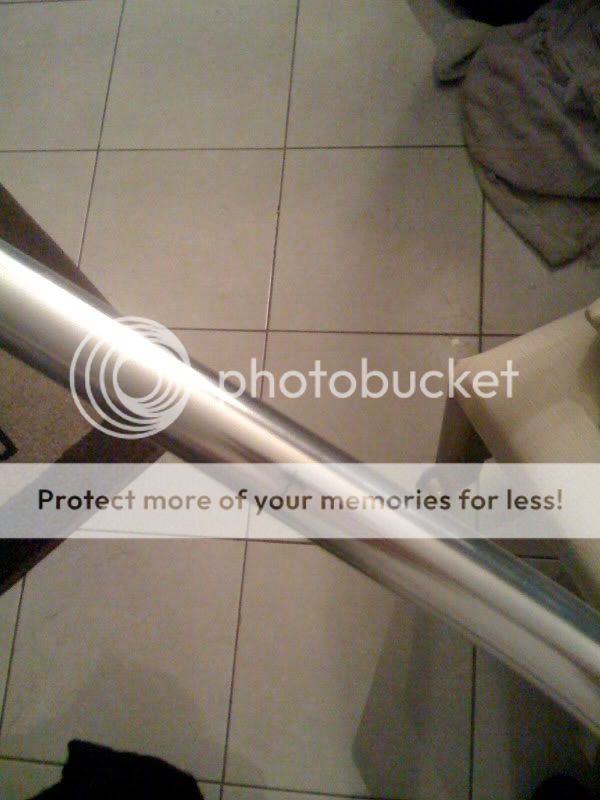

measure 6 times... drill once... use a slightly smaller drill bit than is needed and wallow the hole a touch to make pins fit...
measure

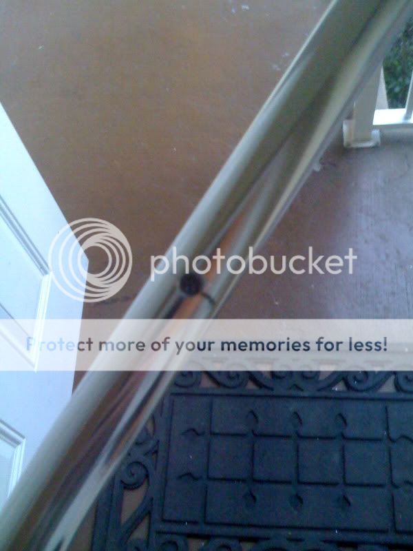

drill.......... once...

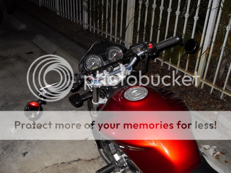

here are the new ones by the renthals... see if you spot the difference..
ok.. it got dark on me and i didnt get all the pictures i would have liked to... but make sure you put everything back in a comfortable place for your hands.. and tighten everything back up... make sure and check the horn and turn signals to make sure no wires came loose..and when you put the new grips on.. USE ENOUGH GLUE!!!! that stuff is cheap.. use it..

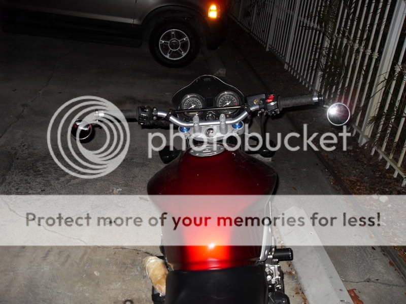

i also installed some bar end mirrors that i have been wanting for forever... and this is the finished product..
anybody needing exact measurements pm me... i will help anyway i can..
voila...
