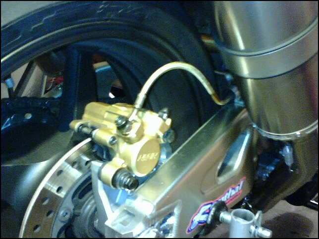

Rear line installed tonight

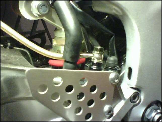

Picked up a banjo bolt today that seems to have done the trick...I'll know for sure after I finish bleading the brakes...I forgot to get brake fluid on my way home so I couldn't finish it

Did you install the washers right? Hard to tell from the pic. Should go
bolt-washer-line-washer-line-washer-master
looks like you may have
bolt-washer-washer-line-line-washer-master

Yes...There is a cruch washer between each line...In the middle there are silver color washers so it's hard to see them(cell phone pics too, sorry)This bolt was from something else and two crush washers had to be used at the begining to get them to line up correctly with the passages in the bolt. It's the correct diameter but was just a little on the long side. If this seems to cause an issue I'm gonna go ahead an order a new one but I think this will be fine. Everything is tight, secure and leaak free
