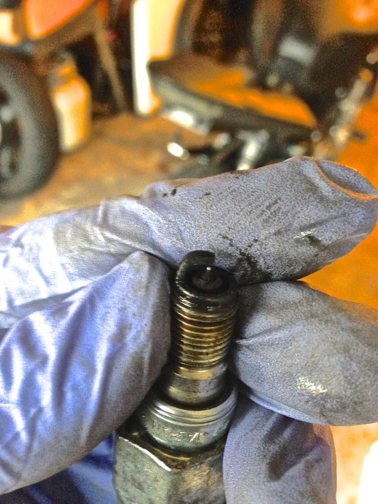

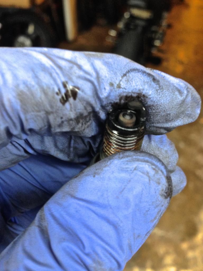

Haven't tried Lucas since the sea foam works so damn well.
Originally Posted by EatDirtFartDust View Post
But don't overdue it with the Seafoam. That shit is hard on rubber seals/hoses/gaskets if too concentrated.
A bit concerned after reading those comments. So I've always been blowing a little black smoke (Fuel) for a while. Recently I tried Lucas because it was much cheaper than seafoam in a large quantity. Now I am blowing a huge puff of white smoke when torquing the throttle for a wheelie or hard acceleration out of a corner. (Looks like I just did a burnout) Very concerned that the gasket may have finally given way.
Hoping it's the cleaner breaking everything loose and burning it off but the smell is almost sweet. Also noticed my oil level (while resting on a stand) is slightly lower.

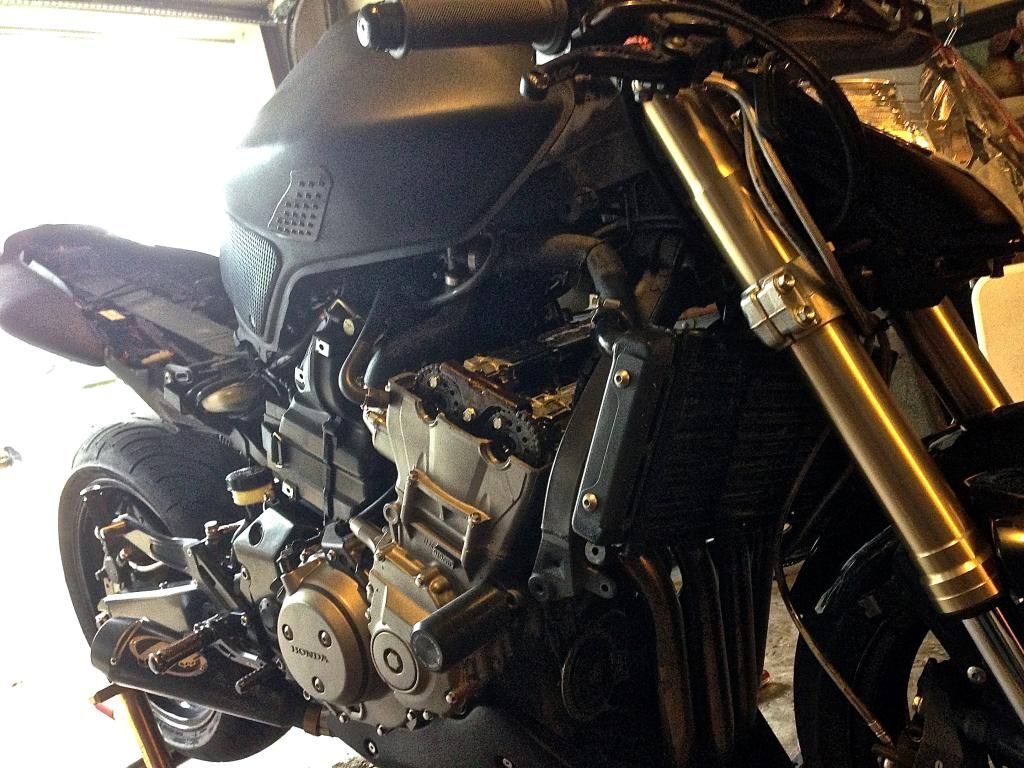

If it is the gasket: I would like to upgrade the pistons and other internals while I'm in there getting my hands dirty. Searched high and low but can't find any aftermarket pistons/parts for a 919. Safe to assume they aren't made for a niner?
Any and all feedback/constructive criticism-(Clorox) is greatly appreciated.
<Small puff of smoke

We're talking fuel system cleaners, right? I think the thing to avoid is letting the stuff sit in a rubber fuel line or carb bowl for extended periods. Just ride the treated tank out asap. I have used Techron (believed to be the harshest) for years and never had a problem. The most likely cause of puffs of white smoke would be valve stem seals / guides. Black smoke is caused by a fuel mixture too rich. Neither of these symptoms IMHO could be caused by Seafoam.
Crap, Valves seem more likely now that you mention it. I'm at 54k. I'll give that a go now. Thanks Ken!

Wolf, have you replaced your 919's fuel pressure regulator yet? This is a known issue with the 919s where it fails and the 919 keeps running richer and richer and eventually start emitting black smoke.
post #7 of 61 Old 02-22-2015, 01:24 PM Thread Starter
Nope, this is the first I've heard of that issue. About how many miles till one has that problem roughly? My temp sensor went out a while ago and replaced it.
post #8 of 61 Old 02-22-2015, 01:31 PM
Posts: 2,326
As I recall, some people had it start to fail as early as 20K. Check the archives for more info on when it fails.
Temp sensor going out is endemic to temp sensors - they are thermocouples in a brass or plastic case and they all eventually go inaccurate or burn out. General rule of thumb is that a vehicle's temp sensors should be replaced about every decade.
Regarding your prior question about pistons: Wiseco does or did make piston sets. They have turned up on eBay every so often. This was the next to last (somewhat improperly described) set to show up there: Wiseco Piston Kit R919 Honda CB900 CB900F Models | eBay
Failing that, Diamond Pistons can make whatever you want, custom: http://www.diamondracing.net/

leak down test will show you what's going on

Well crap! I replaced the FPR part # 16740-MCZ-013 from Partzilla for $59. Fired her up and still blasting smoke! So I opened the valve cover
... Everything is within specs at 54k miles! .005-.006 on the intakes and .009-.010 on the exhausts.
The spark plugs were wet and black. It it just a matter of needing new plugs?

how long did you run it after replacing the FPR... I could see it taking some miles to clean everything out... Also, fresh plugs couldn't hurt
post #38 of 61 Old 03-05-2015, 12:34 PM Thread Starter
Just ordered a new set of iridium plugs for $27. I did notice the third plug was a little loose. Would that cause all plugs to be this wet?

No, a loose plug on one cylinder won't affect the mixture going into the others.
What was your fuel mileage like, when you were getting the smoke issue? Was the bike using noticeably more fuel?

"... Everything is within specs at 54k miles! .005-.006 on the intakes and .009-.010 on the exhausts."
When Ken talked about maybe worn valve seals and guides being the issue, that is not eliminated by doing a check on the valve clearances - it's great that they are in spec, but you could still have an issue with wear on those parts letting oil past and into the combustion chamber.
It would be interesting to know what happens to your exhaust colour when you open the throttle after coasting down a long hill with the throttle closed.
If you have wear in the guides and seals, the vacuum in the engine will suck oil past those worn seals, and when you open the throttle afterwards, there will be a pale blue smoke in the exhaust, as the oil gets burnt off all at once.
Can you get a friend to follow you along and check it out, somewhere? Are there hills in Dallas? Or a long downhill off-ramp?
