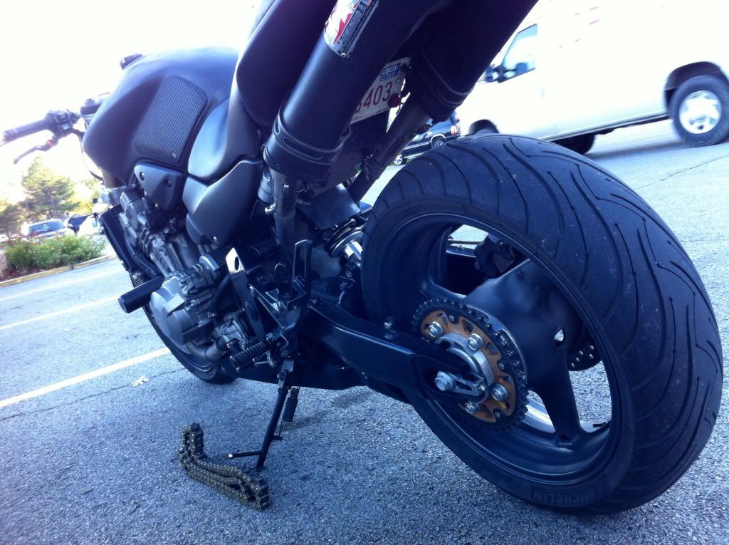

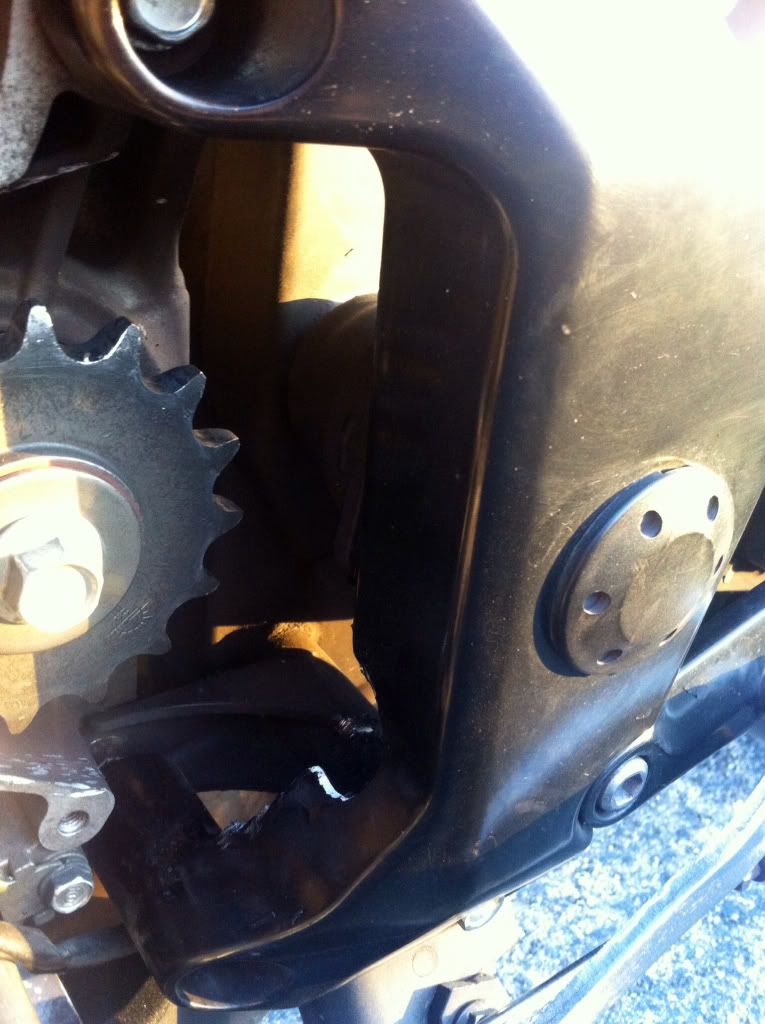

Chain kicked out during a third gear wheelie. The chain slapped up my exhaust caving it in and broke my chain guard and side cover. Fixed it and immediately went home. This morning I noticed I was missing 2/10ths of a liter of oil . So I held up a white piece of paper to the back of the exhaust and it was sprayed immediately by oil
I went straight to honda to diagnose it. They assured me that by holding the front end up so long the oil was getting in the airbox. Being assured and relieved I did a high wheelie leaving the Honda shop
Side note I am selling the Yoshi's for 150 plus shipping. (Still work and sound great, I'm just too damn OCD)

you got LUCKY that the chain didnt bunch up at the front sprocket and break the case.
What kind of chain? rivet or clip style master? and how much slack was on it?
It was a Jt chain with a clip style link. The master broke after there was too much slack in it. My fault

post #13 of 28 Old 11-08-2013, 05:39 PM
there is your problem...
DID with rivet style ONLY on street bikes.
You might be able to get away with lesser stuff on smaller HP dirbikes and whatnot.... but street is not worth the risk... you got off LUCKY that the chain didnt do more damage to you or the bike.
3rd gear wheelie is easy btw.... get her up in first and shift through the gears. I usually run out of road by the time 3rd is grabbed. Not sure about oil starvation... i know the stunt crowd who stand at 12 oclock have to do stuff with the oil pickup etc to get it to work properly.

It is probable that the chain parted because the master link clip was installed facing to the outside. I know that's the usual way to do things, but in this case the chain runs so close to the outer frame plate it can actually hit it even with a rivet link. The cure is to install the master link with the clip facing inward, which is the way I do it even with a rivet link. Better safe than replacing the cases.
would it knock the clip off even it it was installed properly with the direction of travel (with the open end facing backwards when the link is at the top of the chain?)
Yes, if the exposed ends of the pins are hit often enough they will back out, pushing against the clip until it fractures and the pieces fall off, quickly followed by the plate coming loose.
Often I have TiG welded the master link plate on which absolutely insures it will not come adrift. Yes, it's even possible to do with o-ringed chains -- all it takes is a wet rag and a quick tack on each pin.
