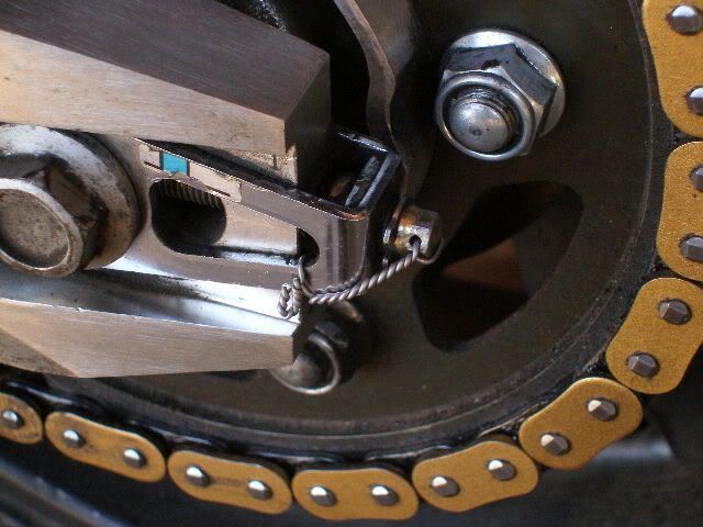

Xrmikey first told me of this issue with the chain adjusters at the start of one of the group rides when I noticed he had safety wired his chain adjuster bolts. When I asked why he told me the chain side adjuster screws itself in when the bike is ridden hard. Thinking it was not a problem under normal circumstances I forgot about it until I removed the rear wheel to replace the tire and noticed the chain was looser than I expected, so I marked the head of the bolt before the last group ride and checked it at the end -- it had backed out (actually in) by almost 1/2 turn! For obvious reasons it only happens on the left side. No wonder I had to adjust the chain so often. Needless to say I drilled the head of the left bolt and am safety wiring it after adjustments. This happens with the axle nut properly torqued (in case you were wondering) and I do not recommend overtightening the axle as a cure due to the increased load compressing the bearing spacer which can cause excessive side loads on the bearings -- very bad on standard deep groove ball bearings!
This also taught me how to align the rear wheel by spinning it and listening to the chain -- if it is as little as 1/4 turn different the chain gets quite noisy from the side plates contacting the sides of the sprocket teeth, which can also affect the life of the chain by continually compressing the o-rings, wearing them prematurely. Once it is aligned the noise practically disappears.

Yup. I just loop the safety wire through the outside cutout in the adjuster, then through the hole in the bolt head. Remember the bolt tends to rotate clockwise (loosening the chain), so make sure the wire is stressed to prevent motion in that direction. I'm working on a more elegant solution, but in the meantime this works quite well.

Rob: Could you please take a photo.

No need to drill parallel to the flats of the bolt -- there is not that much force you're trying to restrain with the wire. Remember to chamfer the hole on each side with a larger drill bit to pervent a sharp edge from cutting through the safety wire.
Ideally, there should be a hole drilled in the body of the adjuster as well, but where it is at the moment is quite adequate.
One thing to keep in mind whenever safety wiring is the direction of rotation you are trying to prevent: usually counterclockwise to stop loosening, but in this case clockwise to prevent "tightening", or allowing forward motion of the axle. A finishing touch I always do is to twist the end twice as long as needed and fold it back on itself to prevent snagging cleaning rags, or more importantly running a finger through with the very sharp clipped end.

Rob: Nice looking chain! How many links?
post #14 of 69 Old 11-20-2008, 01:31 PM Thread Starter
Posts: 2,428
112 links. Wondered if anyone would notice that from the position of the adjuster. Hasbeenracer just handed it to me when he saw (and heard) my previous one, damaged by a misalignment caused by the mobile adjuster. Xrmikey gave me the slightly used sprockets that are on it as well. I tell you: this forum really rocks. Thanks guys!

Thanks for the pic Rob!
post #18 of 69 Old 11-20-2008, 05:50 PM
thanks for the picture rob

Any wire will work in a pinch, but as you aren't really sure of the metal or quality it is a very poor second choice to stainless wire.
0.032" diameter stainless steel safety wire made to NAS specs is available from a variety of sources, particularly auto speed shops or motorcycle accessory stores worth a damn.
Here's a listing from Aircraft Spruce as an example.
http://www.aircraftspruce.com/catalo...safetywire.php
They also have tools such as twisting pliers and no notch twisters, bolt and nut drilling jigs, and sheetmetal nut covers that are not as secure as drilling the fastener, but one hell of a lot faster (and probably won't work in this application).
http://www.aircraftspruce.com/menus/...wiretools.html
By the way, the wire in the photo I posted was twisted by hand and cut with standard side cutters, so the trick twisting pliers are not really necessary.
Once you have a spool of safety wire you will find hundreds of uses for it, and at less than $10, a one pound spool will last a lifetime unless you are running a racing program, in which case it will only last half a lifetime.
