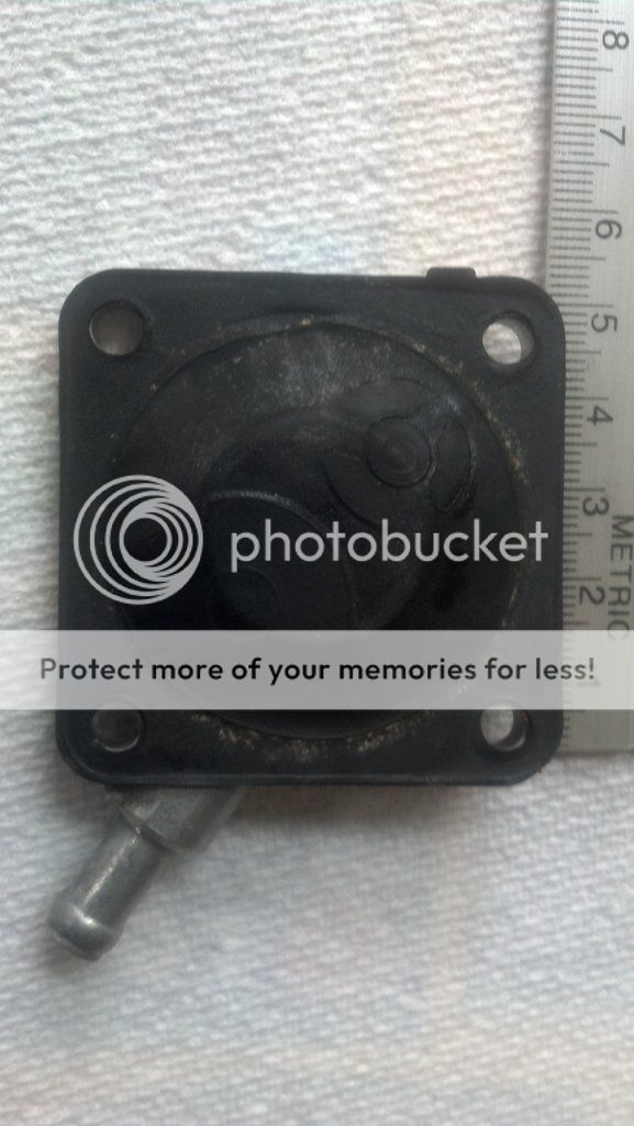

I think this is the culprit. Now to see if they sell just the diaphragm, or if I need to buy a whole new unit.
I really think this is it. Rear cylinder was getting a little extra fuel from the pump. The wet spots are where it was weeping through to the vacuum side.
post #16 of 21 Old 10-08-2012, 11:49 AM
Posts: 5,797
Very likely.
And if one is duff from aging and not mishandling, then the other one is likely on its way also.

Confirmed. Put a temporary fix in place until I can source the right material, started it up, and it's so much better. Held an idle speed very well now.
It's a single pump that feeds both carbs; was just driven off of the rear intake.
Evidently the vacuum petcock is failing now too. The rear cylinder was full of fuel when I went to start it. Should be okay for now with the fix in place; I'm 95% sure that it went through the fuel pump and into the intake, not through the carbs.
