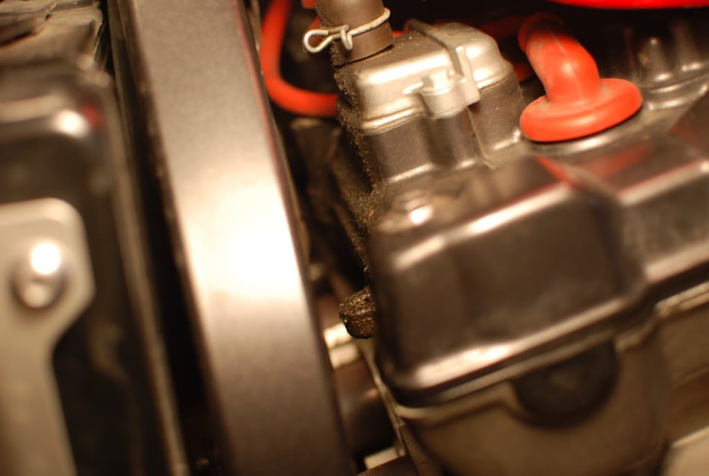

I noticed a build-up of gunk on the front of my engine, and what looks to be fresh oil from the engine leaking down the corner of the valve cover gasket and onto the engine. The bike is an 07 and only has 18,600 miles on it, is this a common occurrence with these bikes or has my gasket gone bad already? I noticed it was gunked up by a vacuum hose as well? Could that be the real problem?
Help a poor college student out. 8-)
This area on the corner of the gasket was more oily until I wiped my finger across it

Find the torque values for the valve cover bolts and verify they're at at spec.

Do you know if the PO had valve clearances done at 16K. That's probably when the cover was off. In addition to the torque checks, you may want to clean the oil off and see if it still leaks.
I don't think it's a common problem and as a matter of fact the gasket can be re-used as long as there is no damage.

Could it be weeping from the hose?

Never seen it before. Clean it off and see if it leaks again - it may be nothing more than road grime build-up from oil on the head after the cover had been off for inspection, i.e. a mechanic who did not tidy up.
I bought the bike at 15,455 miles, so I do not believe the PO brought it in for a clearance check.
What exactly weeps from that hose? I am not exactly sure, but if oil can get up there...that's very possible?
I actually remember seeing all that stuff gunked up there before, and I thought it was road grime initially when I first cleaned it up (didn't clean it thoroughly) after purchasing it. I just checked again today not really thinking I had a leak, and it had built up again after a few thousand miles.
I'll clean it up and keep a close eye on it to see where it starts to get dirty first.
I need to buy a torque wrench...lol.

hmm ya thats not leaking from the valve cover, it looks like its coming from the pair port. That hose comes from a cylinoid that in turn gets fresh air from the airbox. the only way i could see oil leaking out of that spot is if the small gasket between the valve cover and pair port on the head leaks AND the gasket between the pair port cover and valve cover is leaking.
wipe it off, and keep an eye on it where its coming from and go from there.

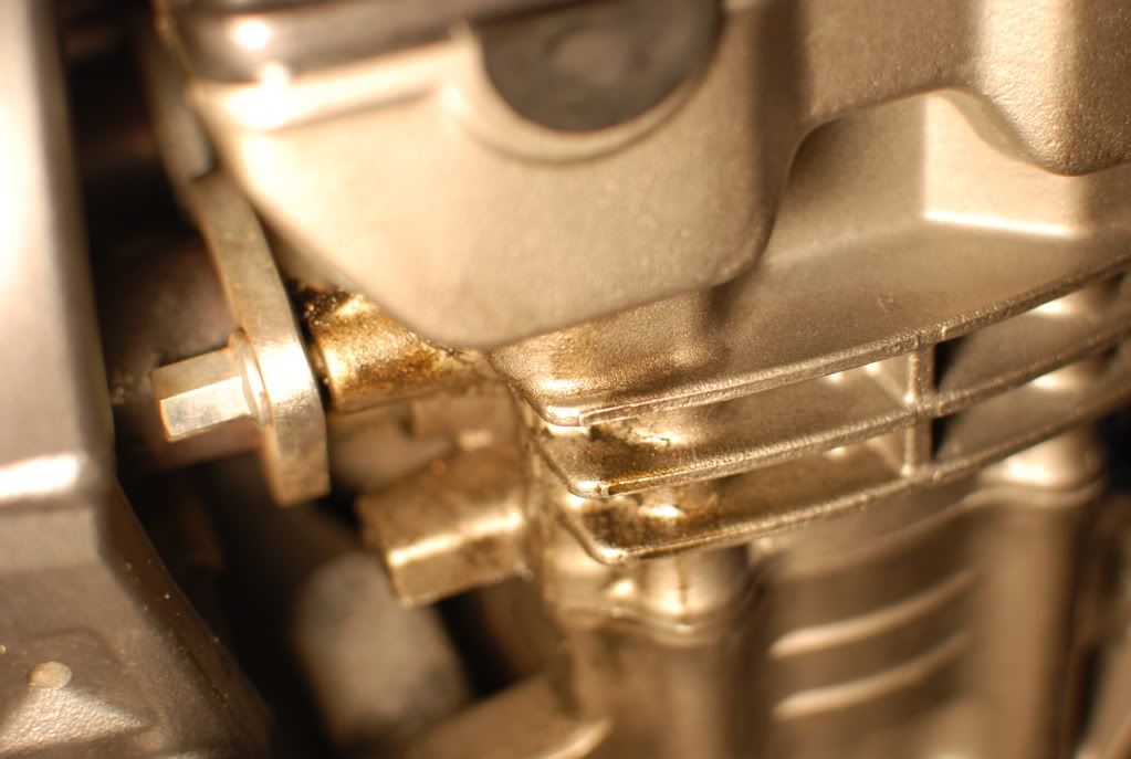

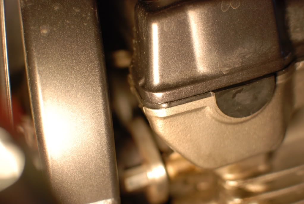

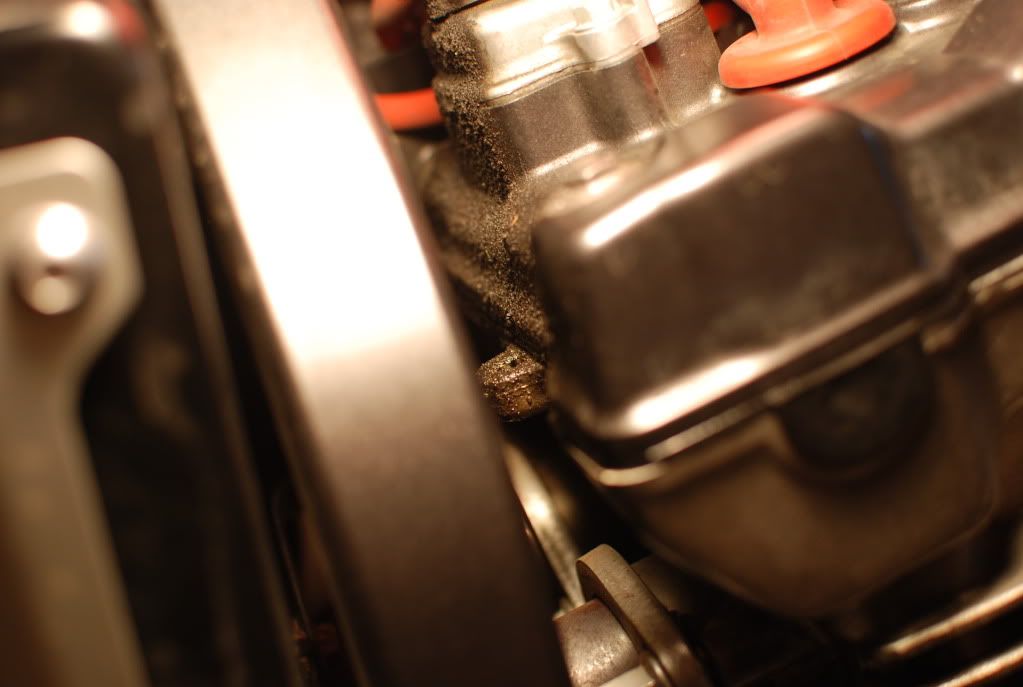

The oil isn't coming from pair valves or whatever it's called haha. It's actually coming from the valve cover gasket. It's not really a leak leak, just very slow...leak? lol. Nothing to be worried about, just makes the engine dirty. Only have to wipe it off every few rides or whatnot. I need to get a torque wrench to see what torque the valve cover gasket is tightened on. It's either not enough or may need a new gasket. I really don't feel like replacing it.
By the way, I have noticed the oil on the gasket after a ride. I have cleaned off the front of the engine so I am able to see exactly where it's coming from. It's odd because I don't believe the valve cover has ever been taken off. It's like it was a mistake from factory.

eh valve cover gaskets can leak, not uncommon. hell my crf250x leaks quite a bit, but tbh i could care less as its really only a drop in the bucket.
get a torque wrench and make sure everything is tight.... put gas in the tank n ride.

I use a purolator motorcycle oil filter. But the problem obviously happened before I got the bike because it was so caked on before I cleaned it, now it's a pretty small small small leak. I doubt the previous owner used purolator for the 16k miles he had it. So I'm thinking it's something different with mine.

I would remove the valve cover and inspect the seal, give it a good cleaning and wipe it down and check for cracks .... if servicable then reinstall with some RTV on the cam cut outs. From the factory it gets blobs of "honda bond" RTV on the cam shaft cut outs & the odds are from sitting the seal or RTV has dried out and failed.
