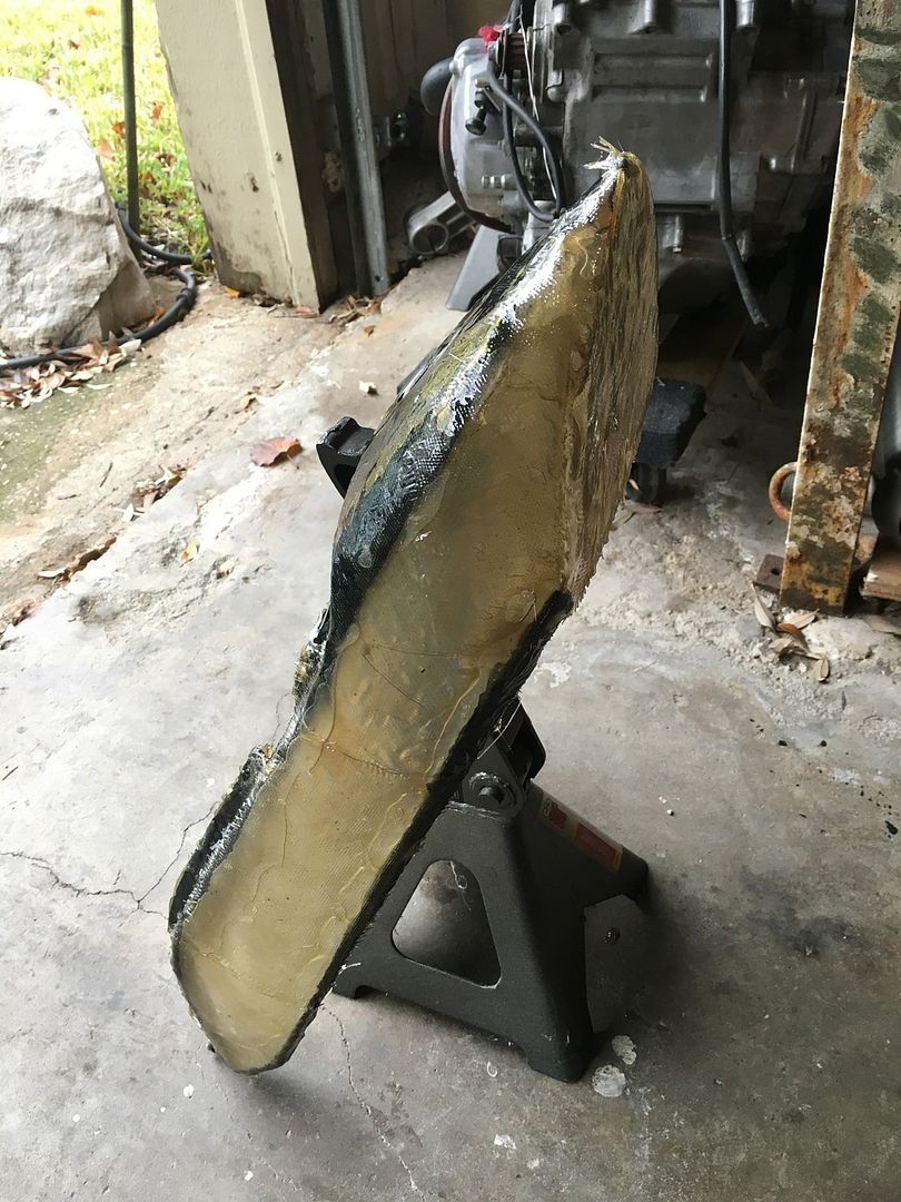

919 Thin Tail

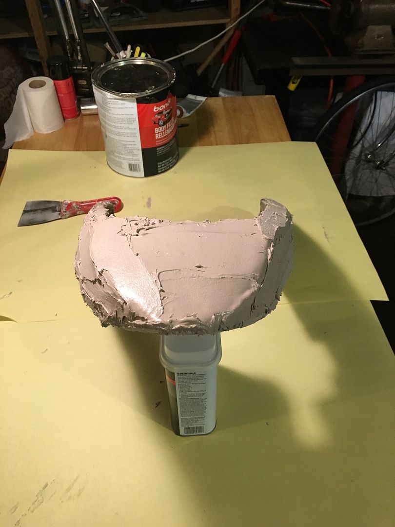

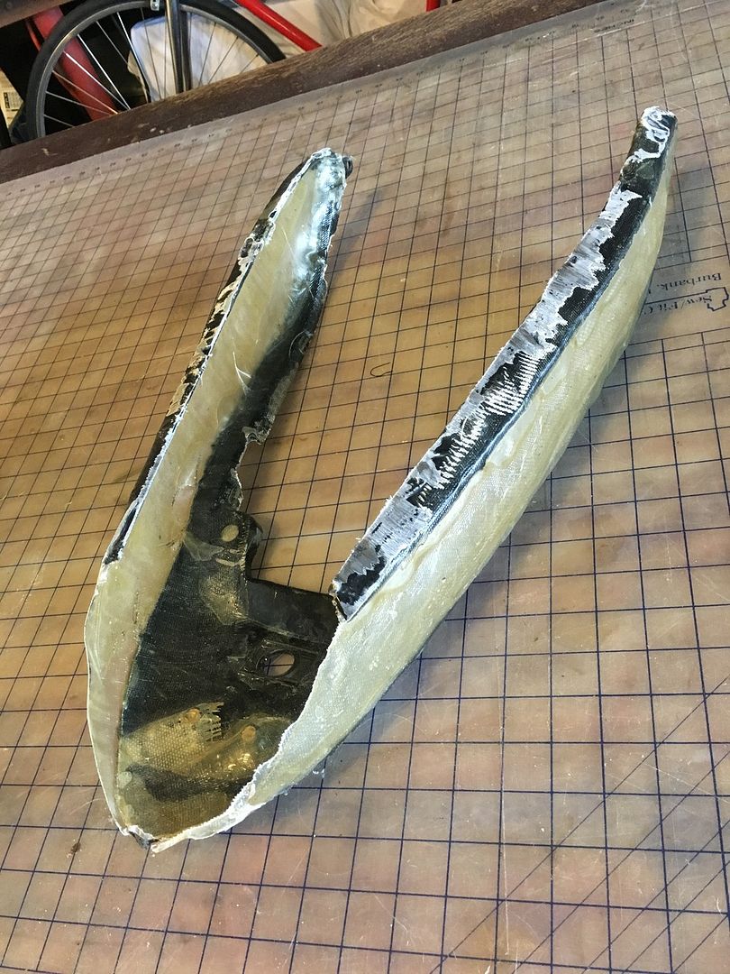

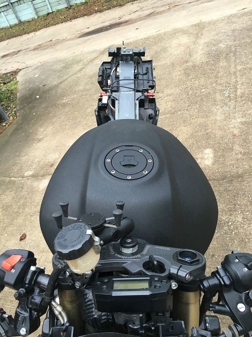

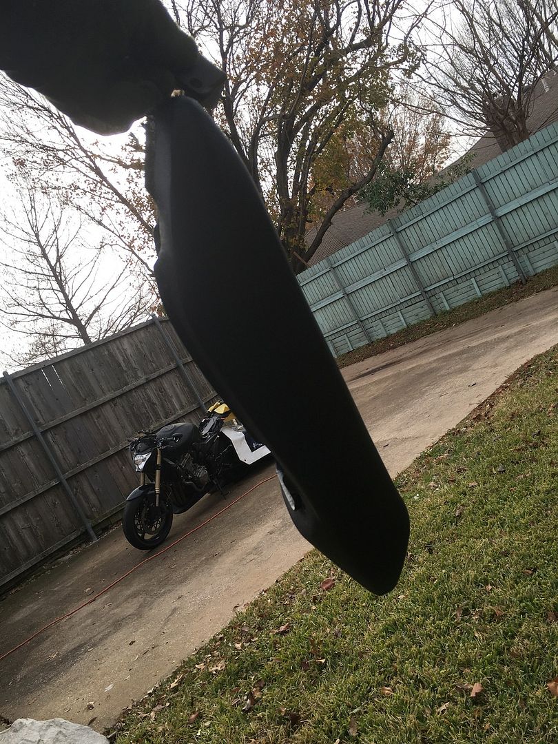

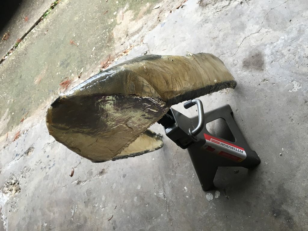

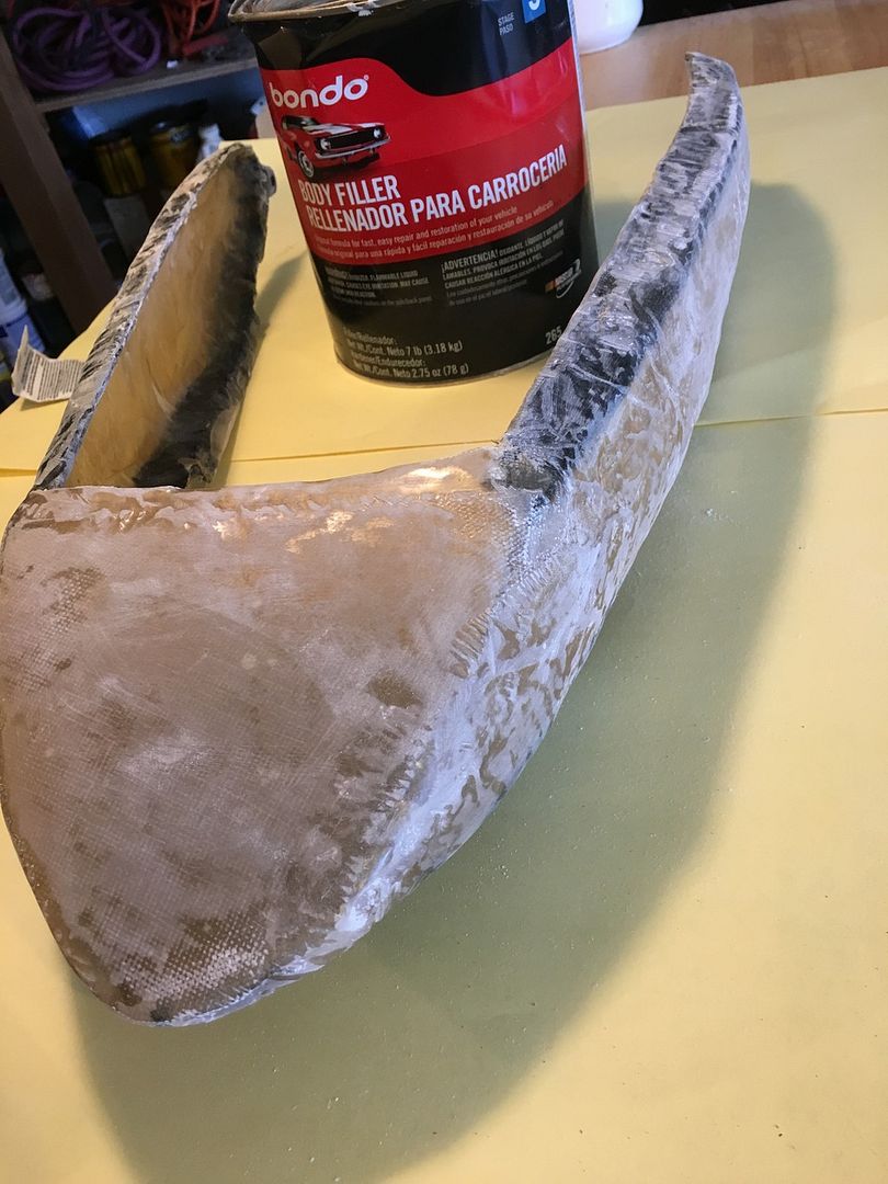

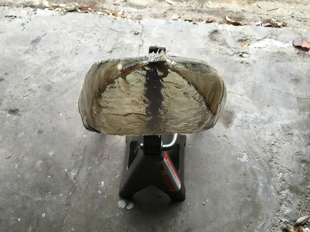

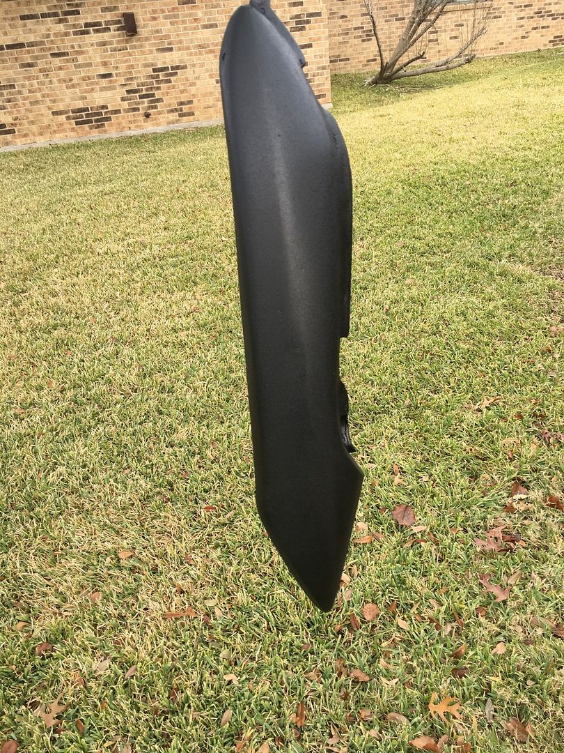

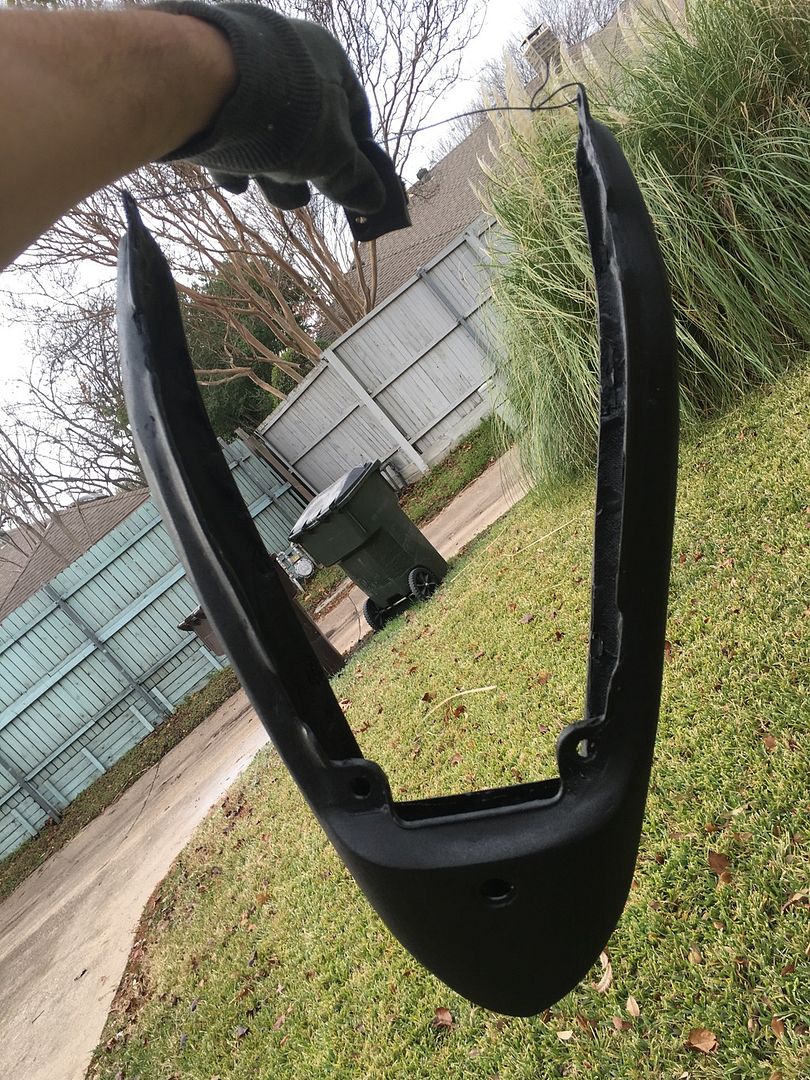

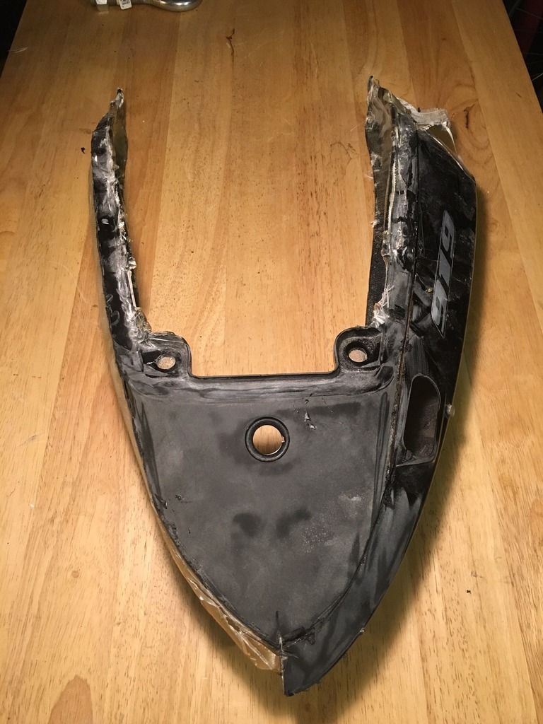

My OCD has had a bone to pick with the enormous width of the 919 tail. So when I had the opportunity to fix that after my wreck I jumped on it. This is my first experience working with fiberglass so please chime in with any method tips if you have them.

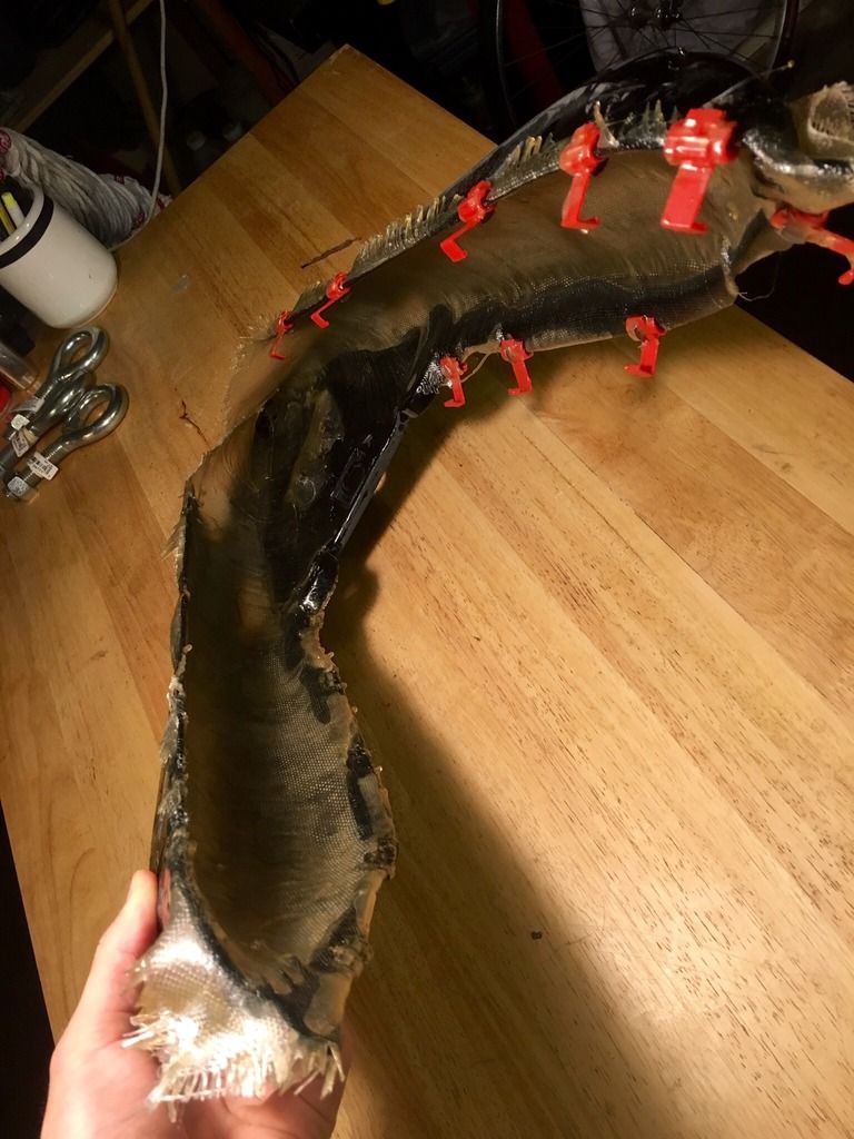

Used gravity to shape the fiberglass cloth.
Each side took 24 hours

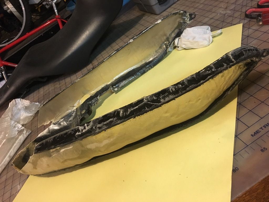

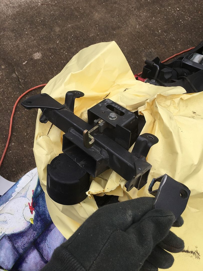

Once both sides were hardened I began cutting the plastic away with a dremil (Ended up using a grinder with a thin cutting blade after burning up the motor)

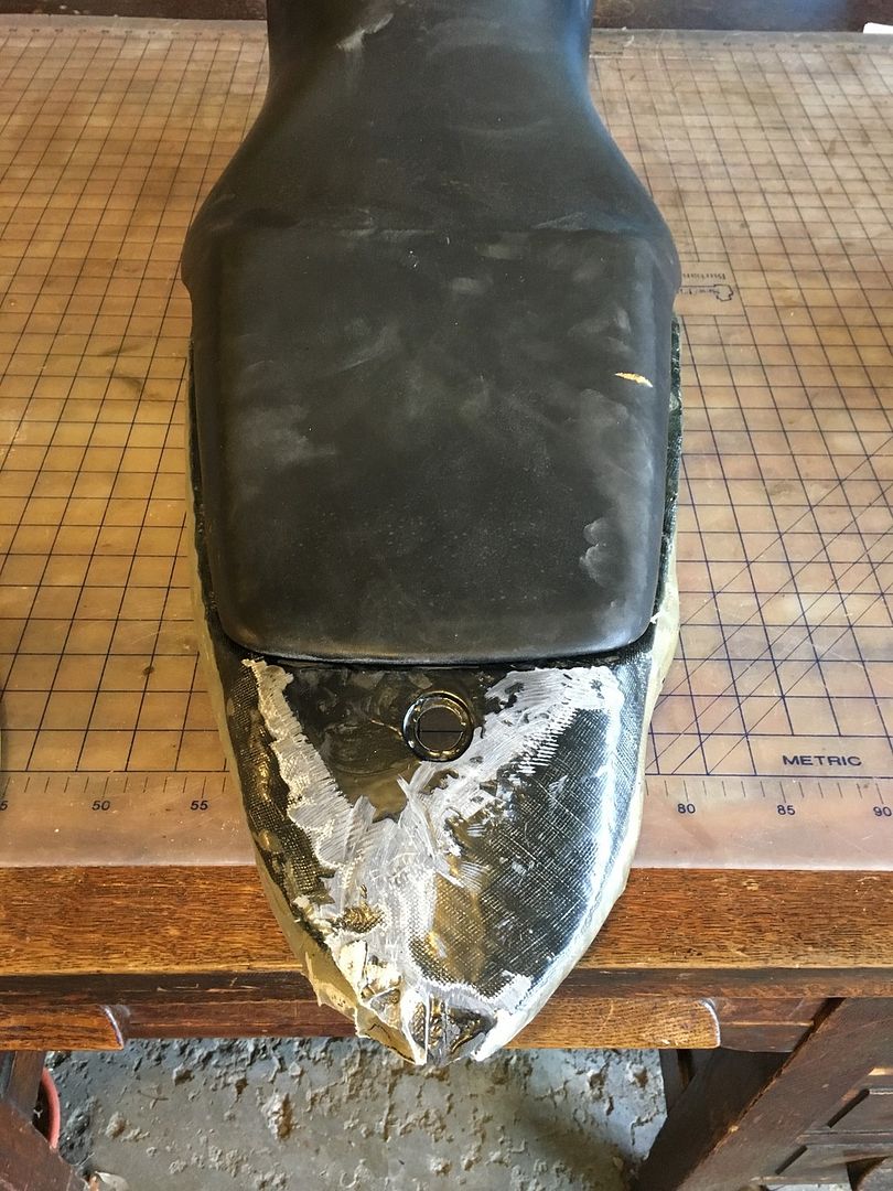

Cut a line to add more fiberglass cloth for the tail

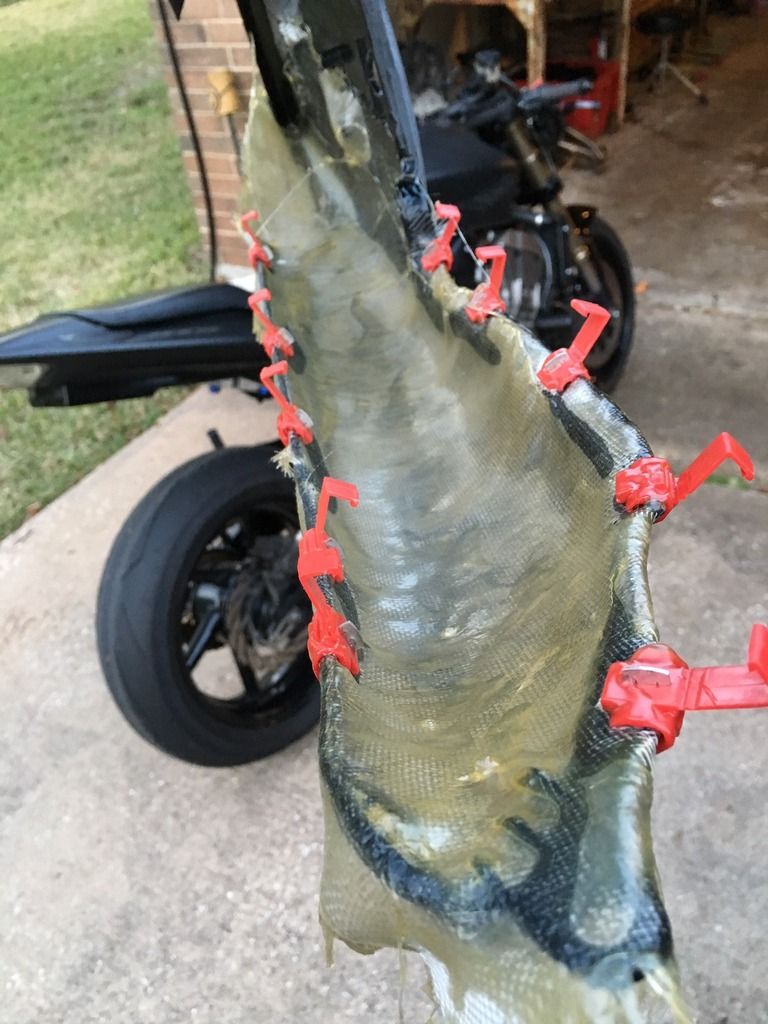

Again using gravity to keep the preferred form
Reinforced with a couple extra layers of fiberglass cloth, cut and sanded smooth.

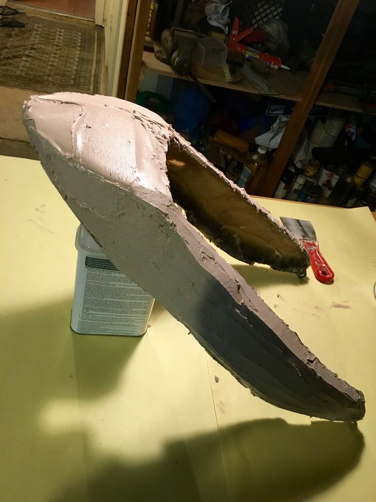

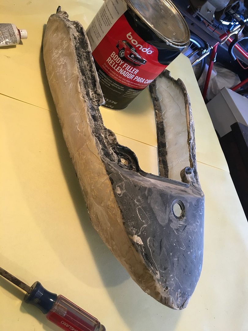

Added Loads of bondo to fill in to the desired shape
Forgot to snap pictures after sanding the bondo. The next step for mounting is cutting the grab rail mounts and painting them to prevent rust.
Left the end of the tail with hard lines thinking I would like it... I will be resanding it soon to smooth out the lines.

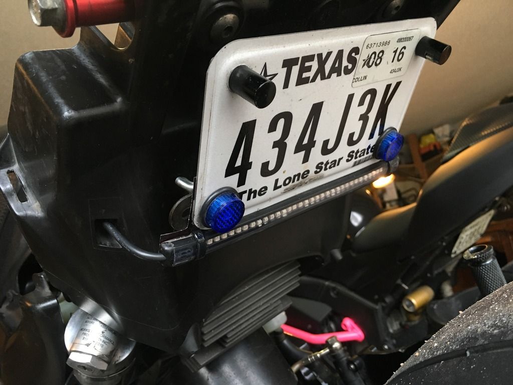

Next was installing the LED strip tail light off eBay for 17-24 dollars.
post #2 of 35 Old 01-11-2016, 08:39 PM Thread Starter
All in all a very subtle and not so noticeable mod... But for an OCD person like myself I am very pleased!
Again the hardline will be corrected and smoothed out. Still playing around with the finished design.
Anyway, hope this helped anyone who might be considering a tail changeup.

BTW, what LED lights are those below the tag?

post #10 of 35 Old 01-12-2016, 11:19 AM Thread Starter
The tail would have been ridiculously light had I not compensated with so much bondo. Which is why I'm going to attempt a mold to make it of either only fiberglass or carbon fiber for the next one.
The old tail with the light and the metal bits I cut off weighed 2.56 lbs
The new tail weighs 2.79 lbs
So yes it is currently heavier but I hope to remedy that with a lighter tail next try.

Looks good, but plate, turn signal, and brake are probably not easy to see.
At least that was my impression from the pictures, so I could be wrong. Don't get me wrong, I love custom bike work, but I don't like to lessen the safety features. Too many idiots in cars with cell phones!
I hope I am wrong, if not, please be extra careful!

The LED's are deceptively bright. Lights up the rear tire and acts as a flashing ground effect. SUV cops and cars can all see my tail light perfectly from behind. The only thing that can't see my tag are the Toll cameras high in the sky.

Here's a link for $14 of the same one I bought for $24: Universal 32 LED Motorcycle Light Strip Tail Brake Stop Turn Signal Flexible 8" | eBay
Come's with 3m adhesive tape on the back and is very easy to wire up. You can get them cheaper from china but it'll take a month to get to you. This one ships from USA. Hope this helps
