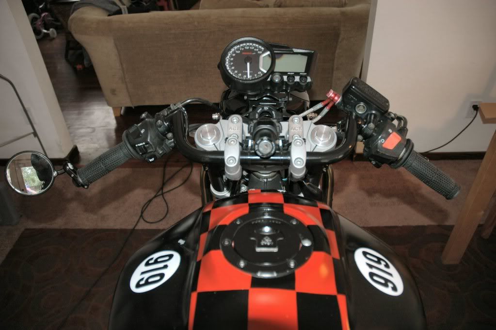

Well, I arrived at my office yesterday afternoon, and found this package on my desk!
So I was eager to open it up and see what i got! Woohoo, it's Rob's prototype adjustable bars, that he posted about in the Naked Section!
Just as soon as I arrived at my office, I just as soon decided to call it a day! Sometimes it's good to be the Boss I wanted to mount up the new bars, and get riding before the sun goes down, so I went right at it.
My latest handlebar setup was with Clubman Bars. I was debating between Suburban Machinery bars, Clubmans, or Converti-Bars as my next set-up, but ultimately decided on the Clubmans.
In the original mounts, the Clubmans were too far forward , making it too much a stretch for my 5'-9" reach. Here's a pic of them in the original mounts (I realize I could use me as a model, but I figured she would serve that purpose better... even though she's not actually reaching for the bars!)
So I had to look at options for bringing it in closer. I found these vintage ACK adaptors on Ebay for $25, which would allow me to bring them up about 3/4", and back 2-1/4".
The move back worked out well enough, but I now needed more height to clear the tank . I could only adjust the Clubmans so much, before the angle of the bars would be too uncomfortable to work well. I had to look for yet another type of riser adaptor that would bring them up further, and maybe not too far back. The point being... it would take time, patience, searching and purchasing risers through trial and error to get make the Clubmans work for me.
So I went ahead and did the swap. No pics here of the process, since it's pretty straightforward how to swap handlebars. So this is what it looked like once I installed them, and positioned them to my liking:
The BIG difference between these bars, and any other bar i could think of, is how easy it was to get the bars exactly where I wanted them!!! No need for trial and error, wasting money buying different handlebars with the hopes that they'll fit me better than the last (I went through 5 handlebars so far, and although I had no problem riding with them, they never seemed to be "just right" for me. I figured when I had the time... again... I would try another set of bars, and so on, and so on).
These bars mounted up easy. The first thing I realized, though, when trying to adjust them, is that it needs calibration lines on the riser tubes, as well as the bracket. Some type of markers to help me be sure that the bars are symmetrically set, before I clamped them down. Another issue was that the clamps were very tight, and it took alot of twisting and muscle to move them up and down the riser. I should note that the center riser bars are temporary for the purposes of this beta-testing, and Thar Engineering will send me stainless bars in the near future, so maybe it just has something to do with actual differences in diameters (milimeters) of nominal 7/8" stainless bars. vs. 7/8" steel bars?
But the BEST thing about these bars is that I was able to get the bars exactly where I wanted them on the first go at it!! I can rotate the center section forward or back, as it pivots on the bracket mounts. Then, I can rotate the bars to get the desired setback I want. The combination of the 2 rotating points gives you a wide range of adjustablity. I'm gonna ride it in this position for the next week or two, then in three weeks, I have a Charity Ride to go on. I'll set it up where I rotate the riser to be more vertically set, and adjust the bars accordingly, for a more upright riding position.
One thing to note, in it's current position, is that I cannot bring the controls closer in, because the master brake resovoir will hit the riser bar (because of the forward angle I have it set at). I do intend to swap that out with a GP style resovoir, so that won't be an issue. If you don't want to rotate the riser bar that far forward, it won't be an issue at all. Right now, I have the grips just about where I want them if they were to be in the "touring position". The bars arrive with a 12" length, so the combined width of the total assembly can potentially be as wide as 32" from end to end. I don't need that much width for my bike, so I'm just gonna cut off about 2" from each bar (right about where the grips end in the pics), for a max width of 28". Once I get the new resovoir, all is good! I'll be able to move the grips another 1-3/4" closer in, giving me a width range from 24" to 28" once it's set and done. However, to get it down to 24", I will then need to consider how the clutch cable will route. Nevertheless, I don't think I want it that narrow, and will likely set it at 26" from grip-end to grip-end, when I have it in the low position.
Anyway, I took her for a quick ride today, which included some freeway high speed excursions. All I can say is I am very, very happy with these bars! I really don't even want to move them, since they seem to be in the perfect position for me, but it's great to know that I can play around with them all I want! And without additional "costs". Because of its multiple adjustability, I am certain I can find other positions that will fit me just as well. I can lower the bars about another 3/4" before it starts to hit the tank, so I may try that, but for now I am as happy as can be in its current position... a position, I will remind you, that I configured on my first go-around.

I think we can start calling these "Thar-Bars". I called them Thar-Bars for short in a few other forums I posted this on, the name kinda rung a bell with others.
One guy wanted to know when these Thar-Bars will be out on the market. I'm not getting too many responses on them yet, but those that have are very interested and want them NOW!
Rob, once you get the final version out (and I do think it needs calibration marks)... you got gold here, me thinks!

As you know Rob919 and Igneale got beta testing bars. Well, there have been a few changes.
I moved the clamps to the center section and have a variety of handle tube configurations planned. This illustration duplicates the Revision 1 bars. The top two are the lowest that can be fit, and the bottom uses bent rather than welded tubing, which I think looks better, but limits the lower position to 1.375" higher than with the welded tubes.
The "horns" on the REV 1 bars have been eliminated for safety and aesthetic reasons, but this is not without a downside -- the range of height adjustment is limited by clearance between surface of the triple clamp and the lower saddle of the handlebar clamp, in this case about 35mm. It's not as bad as it sounds due to most lower positions also are rotated forward in the triple clamps as well, giving more room.
As soon as I get all my supplier ducks in a row they will be for sale, so keep an eye out for the announcement.

I really like the original setup I have right now. Everyone who's seen my bike in person, and not just thru pics, really like the look. In fact, the "horns" don't really look like horns at all, and they think the whole setup looks pimp.
The only problem, for me, with the new style, would be the limitations on height adjustment. That was an important aspect that I found very appealing. On the same note, I am so happy with the position I have the bars in now, that I am almost reluctant to try them in the high position anymore! And I do like the looks of the newer design better!
Whatever the design may be in its final rendition, the defining advantage that these bars have over any other is its ability to allow the rider to set it in a position that's ideal to that individual, and do so at a great price!
