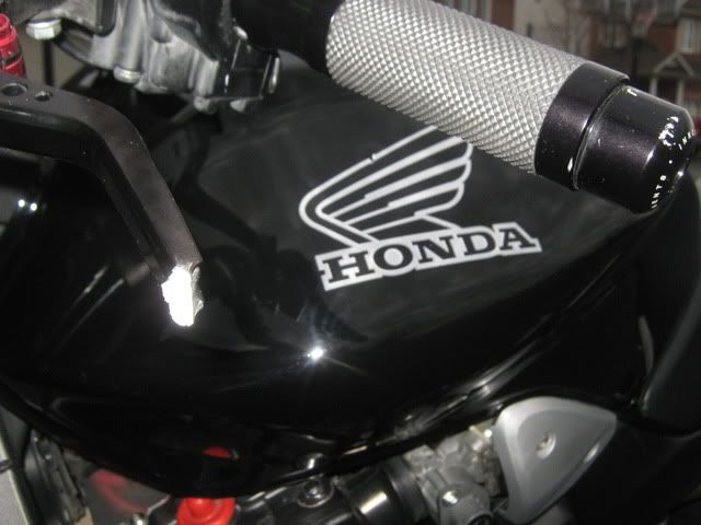

With all my left arms strength I resisted the the falling motion the best I could and I did manage to slow the decent to doom slightly, but not enough. I had the immediate, adrenaline-filled rush of strength and used it to lift my girl back upright as quickly as possible to assess the damage.
Of course, my first check was the infamous dent in the tank from the left control pod impact. My Honda wing decal had a small gouge in it, but there didn't appear to be much of a dent. Then I checked my beautiful Rizoma grips. There was a small scratch on the bar end, otherwise ok. My Chinese, knock-off lever, however, was snapped and lost the last inch. Then I noticed that the engine side case was nicely scratched up.

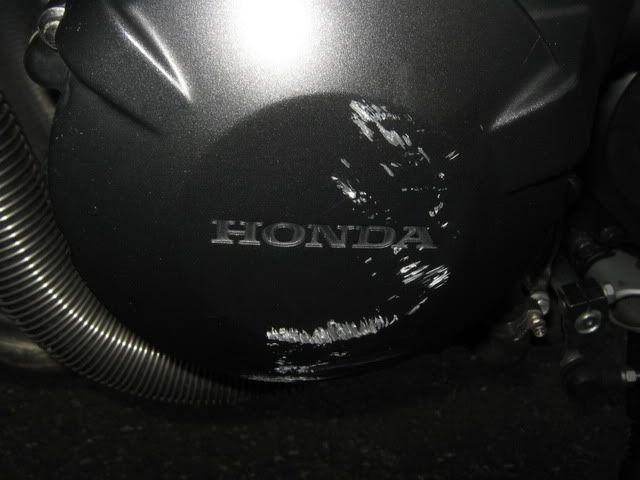

To my surprise there was no damage to anything on the rear end. I guess nothing made impact. I had thought of my beautiful, shinny Delkevic's having dents and scratches in the second that the bike was on the side.
What a stupid mistake this was. I've heard of others doing that, but I was always so careful in how I put the bike on the stand that I thought it would never happen to me.
So all in all, the damage wasn't too bad. I also had to straighten the shifter that was bent inwards. However, the worst was not yet discovered.

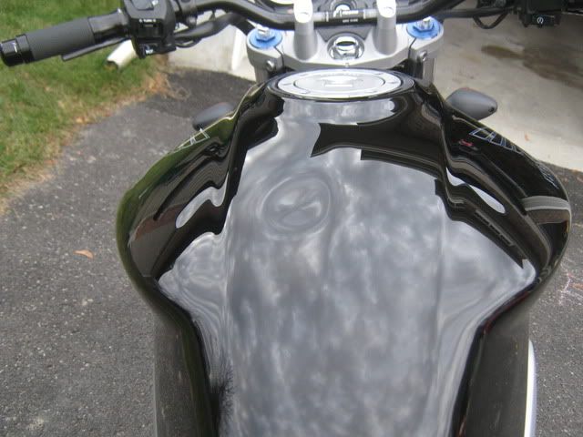

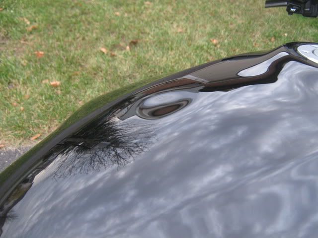

Later, as I was showing my wife the damage I notices a nice dent in the top of the tank!!
All I can think of is that I must have dented it with my leg or hip as I lifted the bike back up in the OMG panic. Stupid!!!
What a crappy way to end such an awesome season. This dent is something that is going to eat at me so bad. Every time I look at the bike I am going to see it. My pristine baby is no longer pristine.

Rickard has/had a magnificent machine that will pull that dent out no problem without any drilling!
It uses hot glue and a bridge. I'm sure we can fix that tank up no problem!

Damn Michael that does suck, but that dent does look like it may be able to be popped back out. The rest looks very minor and can be touched up/ easily replaced. Don't beat yourself up, shit happens. I know that sick feeling. I dropped my bike in a parking lot one week after driving off the showroom floor.

i have heard of people removing light dents by filling the tank with water, and then freezing it, the expanding water pops the dent.
you must keep a regular eye on it to make sure you dont bulge the tank.

might look into the heat gun + canned air method to pop that dent out... dunno if it will work on a metal tank like ours but it works well on stuff like plastic bumpers.

try spraying that dent with compressed air container upside down after hitting it with a hair dryer for about 2 minutes...you'd be surprised what it can do by itself especially if so new.
Compressed Air Dent Removal - YouTube

Thanks guys. It looks like I have two promising options to try. I will let you all know how it works.
I haven't done a search here yet, but I vaguely recall someone finding a close match for the dark gray of the crankcase side cover. Does anyone know what it was?

I don't know the difference, but I believe they are billet machined, like the Brand they are copies of. Would a macro photo allow you to tell?
Ottawa919 is offline
post #32 of 41 Old 11-20-2011, 09:58 AM
Posts: 5,906
I'd expect that the external view will more easily telling.
If they look machined all over on the outside, then I'd assume it's from billet and the reason it snapped, as compared to bending, then just calls into question the grade (supposed grade ?) of aluminum used.
They could get net shape from a casting, and just do the few critical surfaces, but that should be visually apparent.
As for as a billet part snapping, the concern there is sort of along the lines why Woodcraft rear set brackets often don't break and can be straightened, while Vortex items tend to be "snappers".
If one thing comes out of this, should anyone have a brake lever from the same maker as your now snapped clutch lever, if bent in dump, don't keep it - bin it. And worse would be to try and straighten it, have success in terms of no crack appearing, and having the lever part ways at a most inopportune time.

I tried the heating/cooling thing with no success. I did 5-6 heat/freeze cycles, varying technique and it wouldn't pop.
I'm going to go out later and have a look at the dent remover kits that Rickard mentioned.
