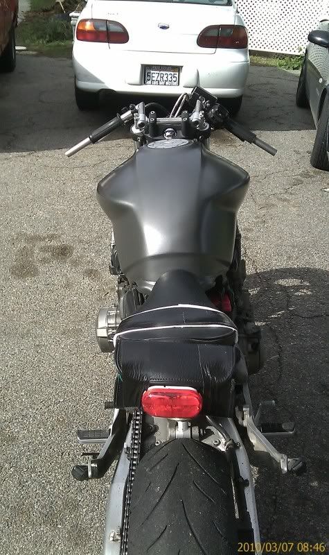

The $64,000 question: what to do with all the electronics? All the original mounting points are gone and there’s that harness … after briefly toying with the idea of wrapping it all with black duct tape and sticking it, uh, somewhere, he did a search for a suitable container for it. Came up with a heavy leather fork bag that he bought years ago and didn’t use -- and the ECU, relays, and connectors fit in quite nicely. All that was left to do is strip the wrapping off the harness and route the wires to fit, pull all extra wire forward, bundling it up and stuffing it in a frame reinforcement. It really looked pretty good. Now how to mount it to the bike? There are two loops for the original bag mounting straps which was the only practical mounting, but with no fabrication equipment available we started looking through his fairly well equipped tool box until I saw a set of long handle allen wrenches and decided the two largest ones would work with the long legs inside a pair of sub frame braces and the short in the strap loops. Cool!
Now for the seat. Again, with no fab equipment -- pad the tank mount with duct tape and literally tape the seat on. It looks very backwoods farm engineering.

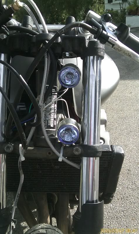

Now for the taillight. Forget the original. Went to a relatively close motorcycle accessory store and found absolutely nothing that would come close, so went to Pep Boys to browse around -- and there it was: a red two bulb truck marker light. Perfect. Since the bag has a Velcro strip on the back we used that to attach the taillight. While we were there also found a pair of Navigator halogen mini driving spots that would serve for headlights. Total investment: $36.71. Back to work.
The front:

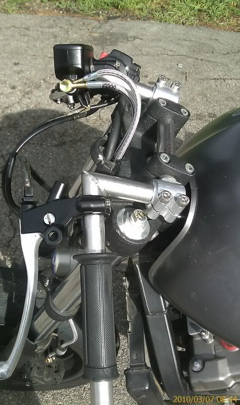

This is a bit easier. Mounted up the TharBars. Installed the new master and brake lines, and spent 9 minutes getting it bled out. Eliminated all the headlight brackets, turn signals, the left side handlebar switch housing -- pretty much everything that isn't needed for operation. Mounted up the spots to whatever we could find and wired them up so both are on at all times, but still cut off when the starter is engaged.
A picture of the adjustable bars:
