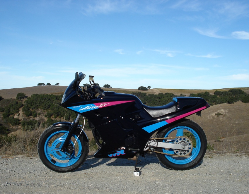

IT"S ALIVE!!!!!!!!!!
A week long soak in a bucket of carb cleaner did the job.
A big thanks to everyone for your help.
I have included a pic of the "Blue Beast".

You need to sell that bike to me
It would make a great stablemate to my 89 VTR250
Dude that thing is a FIND!!!!!!
Congratulations!
